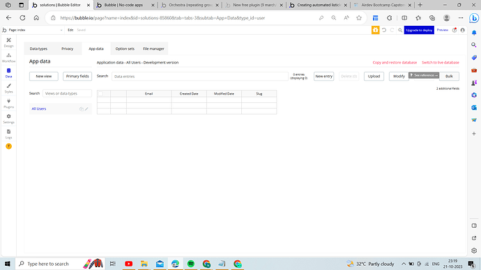

after creating the option sets you can bulk edit your records in this section
see my mouse cursor
