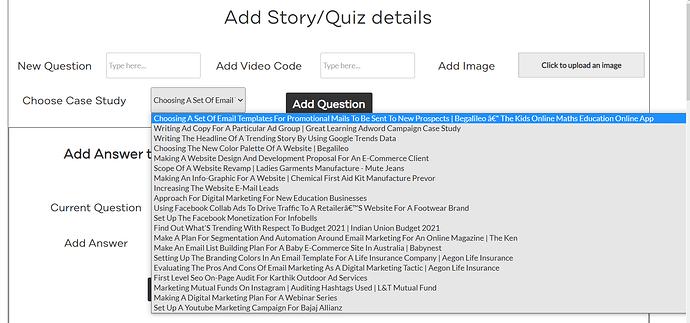

I have taken your advice and added dropdown in the question section. https://bridgegap.learningcatalyst.in/version-test/quiz-questions
But problem is that, I have more than 80 case studies approx. 100 and in dropdown it is displaying all the case studies.
Can you tell me how should I show display only that case study which added in a week or last three days in dropdown?
Nice work getting this implemented! And you’re right, with that many, the dropdown won’t be the best option for selecting those Case Studies. There are two directions you could go with this. First, our searchbox would be much more efficient with that number. You could consider implementing it instead of the dropdown which should bring some performance improvements and allow you to keep the full list. Otherwise, you might consider putting some extra constraints on your dropdown source if you wanted to only show recent items. For instance, you might use a constraint that is something like Created Date > Current date & time +days -21. Essentially, this would only include any Case Studies that were created in the last 3 weeks.
