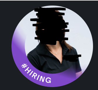

Does anyone have pointers on creating custom photo frames like this one? I want to make some of my users profile pics stand out from others.
Preset overlay PNG images for your frames.
2 images inside an Align to parent group.
Top image is overlay frame
Bottom image is the profile image
Good idea! But if I needed them to be scalable, I would probably need to have conditionals, right?
You can just set both to be 100% width/height and fit to the align to parent group which scales. Any rounding, borders, shadow, etc goes on group as well. That allows you to keep the alignment between frame and image correct.
