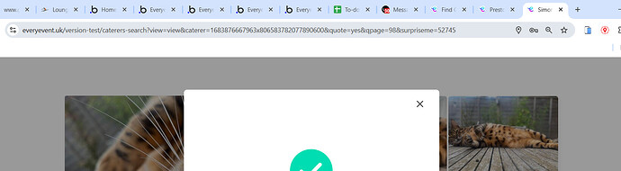

When I save the current database ‘thing’ to the parameter, it’s only showing a 5 digit code instead of the usual long unique ID?
This means that when I try and retrieve it from the URL, bubble can’t find it.
The parameter is the ‘surpriseme’. You can see ‘caterer’ showing correctly.

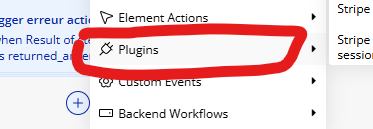

Which action do I use in the workflow to start an API call?
1- create a backend api workflow and make it querryable from the internet
2- install the official API connector plugin
3- create a route inside API connector to call your API backend workflow
4- from your workflow, trigger the API connector route from the “plugin” tab.
5- get the response from step4
