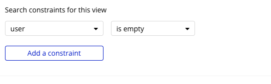

I want to set up a clean job that deletes all data that has no users saved. I just regoningzed a “deleted thing” is not get recognized as “empty”. For example, when I set up a DB view with the following constrains:
Bildschirm­foto 2023-07-27 um 10.17.29
there are no results. Is there any way to specifically search for entries with deleted things? Thank you!
Hi there, @home… try doing a search for entries where user is not in a search for users, and don’t add any constraints to the search for users.
Hope this helps.
Best…
Mike
Thank you @mikeloc , so it works! But it seems a bit strange to me. In ergo it means that a deleted thing is not recognized as an empty thing, right?
To the best of my knowledge, that is correct.
