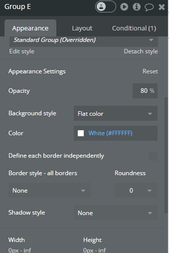

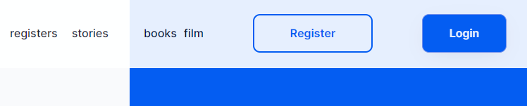

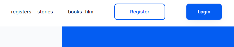

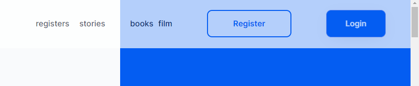

I am giving opacity to a header group its color is white… the group below is blue and i have given opacity so the color of blue group reflects on the upper white group… but it’s blue color is also reflecting over buttons (button color is white) and i don’t want that…
is there any way that opacity of whole group won’t reflect on buttons ?
I just want it removed from buttons
Thank You

Set the background colour of the white group to #FFFFFF 80% or something. That’ll give 80% opacity without passing through to the child elements.
that’s the problem its still passing i need the color of buttons exactly blue and white

Try setting the background colour to arbitrary text #FFFFFFCC. This produces white with 80% opacity. It works for me on the dynamic components app I’m working on, so if it doesn’t for you it’s probably something else in your config

basically it is becoming transparent due to opacity decreased … i just the button to maintain their color
