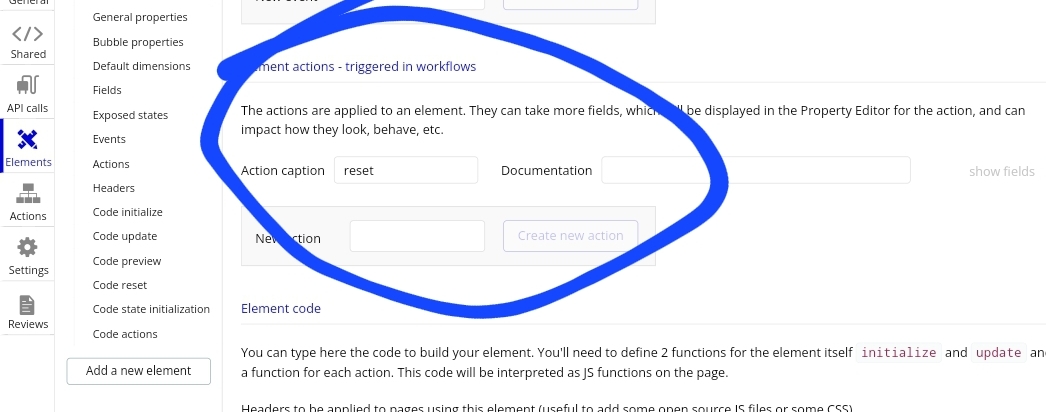

I think, it’s not possible in the plugin code itself. But you can archive this using plugin element actions/events.
Refer below screen
You can trigger this event by every 5 seconds to check the data get updated or not.
