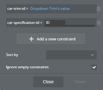

How can I put a manual “ID” into the search? Bubble won’t let me. It wants to do a search for it. Which led to a very delayed result. 11 seconds to show the result.
I believe that direct input will be faster.
Anyone any idea?
I really appreciate any help you can provide.
Fabian
The reason it takes longer than usual is because you are doing a nested search - you should, as much as possible, prevent this.
As far as I’m concerned, it is impossible to manually input something there.

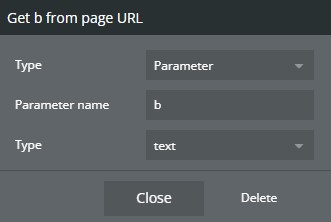

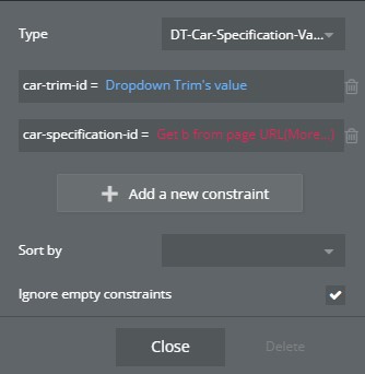

I’m trying to reference the car-specification-id from the URL get parameter but the Bubble asks for “more” and it continues forever with “more”. And about the custom state Bubble does not read it at all.

No. I want to display a piece of text information based on dropdown trim’s value which changes dynamically and car-specification-id which is a static ID. Besides that I want the information to remain on the page in case the user refreshes it or goes back from another page.
Can you show us how you structured your query for getting something from a url parameter?
I haven’t seen your DB structure but I’m guessing the reason why you’re getting errors when you use the state route is because it’s a mismatch in the data type.
All the fields I want are in the same datatypeDT-Car-Specification-Value
