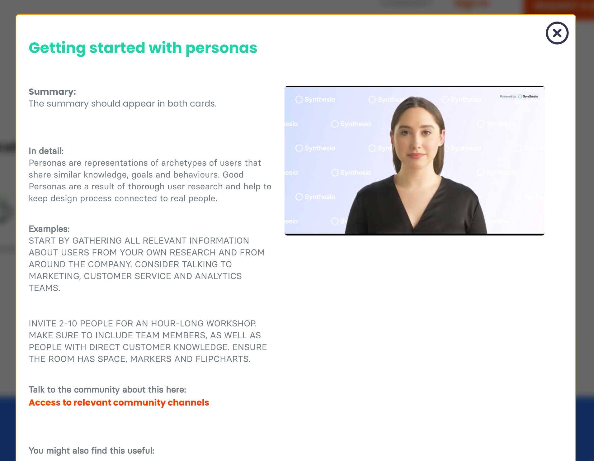

The data source is help + help details. That’s the help card and the help pop up with details.
Also the search is set to .7 i.e. returning the exact words in no particular order in both “help” (name, summary) and “help details” (description, steps, examples, and related help).

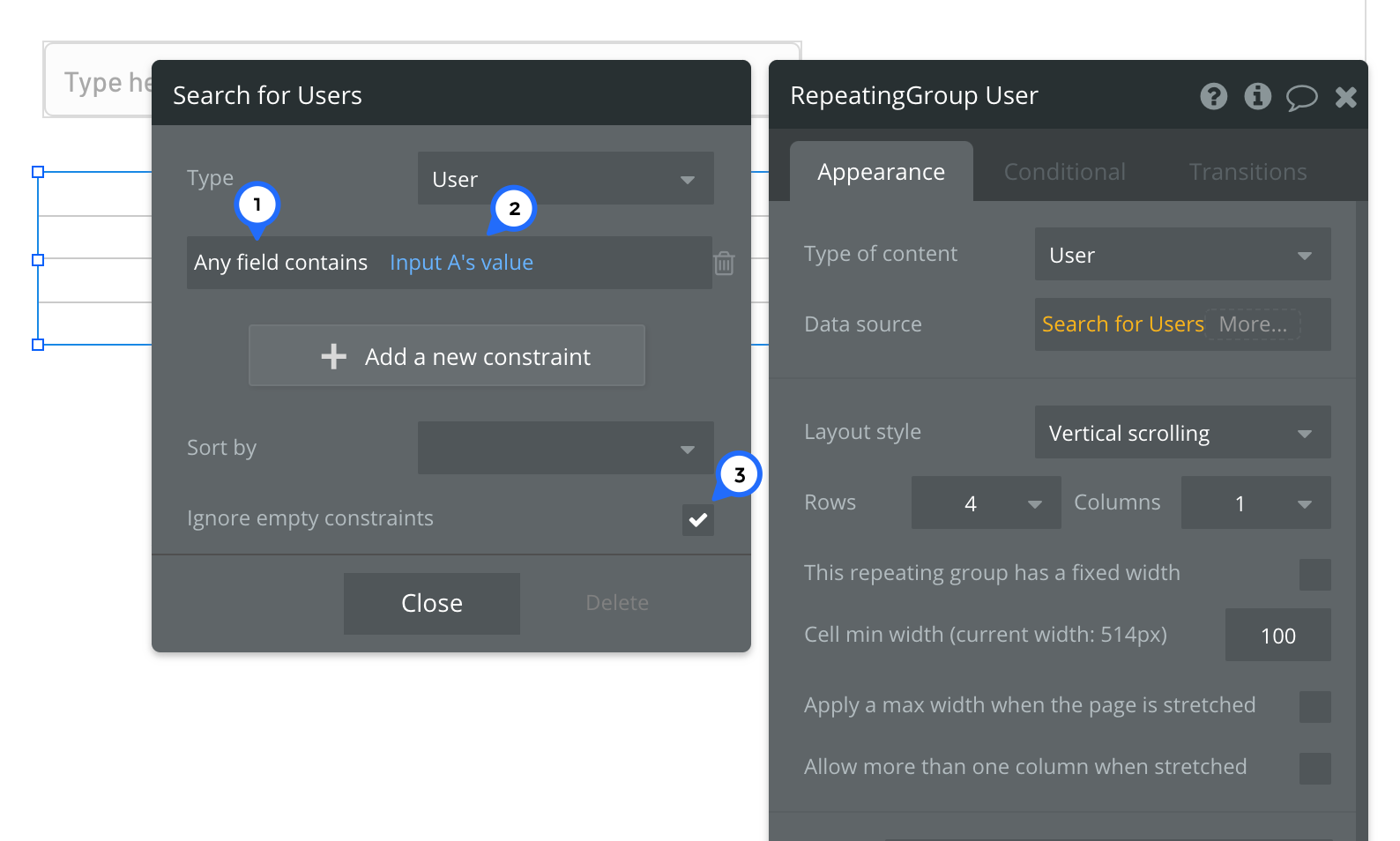

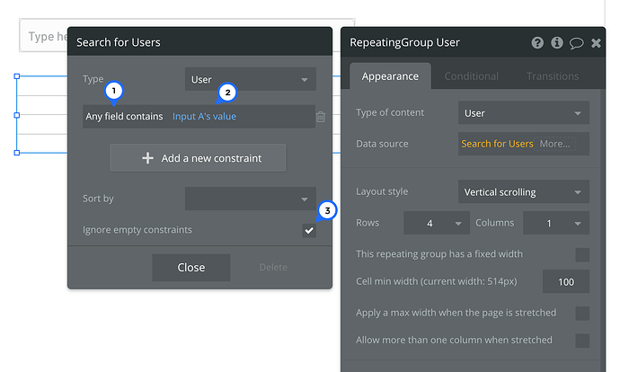

About challenge 2. What if you could do the voice search and NOT store the results in a database, would that work for you?
If I assume that it is OK not to save to the database, what I would do is to change the search in the data source of the repeating group.
Bubble’s built-in text search has improved a lot. But if you want more control, you can use the fuzzy search plug-in. @gregoryjohn has just released a tutorial on that: https://www.youtube.com/watch?v=yiMqvbeYvT0
