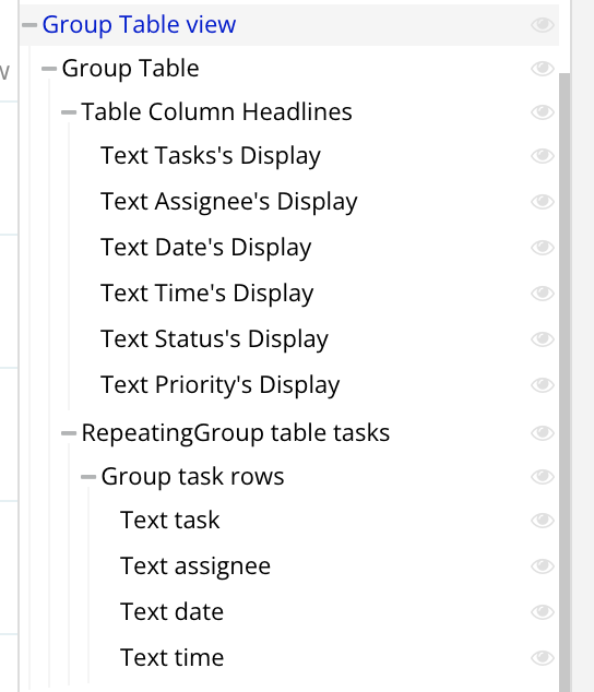

I’m trying to display the Workspace’s, Project’s, Board’s Tasks (and its fields corresponding to the ‘Table Column Headlines’ group) in my RG when a Board is selected (through URL path?).
Nnothing I try has worked so far…
This is my current element structure:
Any help is appreciated!

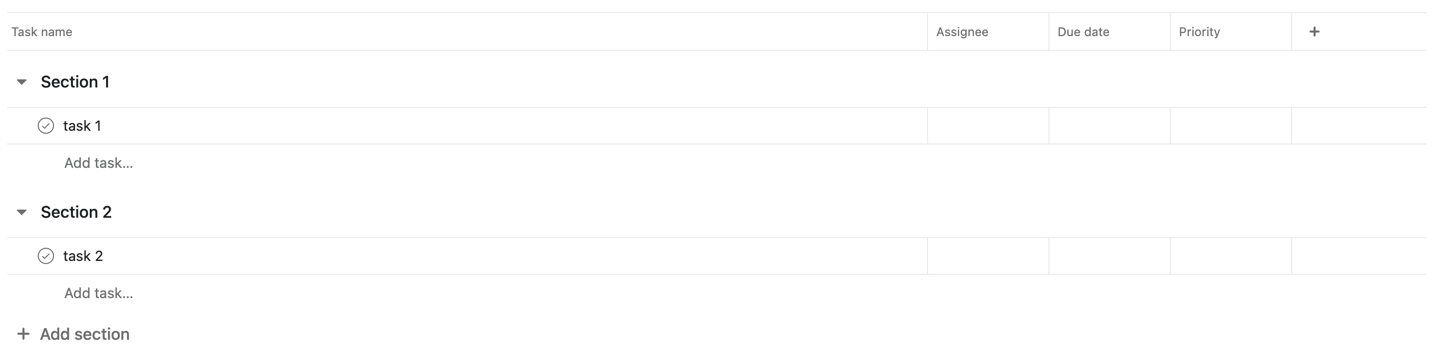

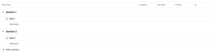

For further reference, I’m trying to build a standard task management screen, as below.
The element I’m using to achieve this is not the beta table feature of bubble’s, but a component from the Bubble Essential Kit (essentialkit.io).
To achieve something like the screenshot above, I’m wanting to show only a single Workspace’s project’s board’s tasks, at a time (per screen/view). Just as you would see on an Asana or something similar, ie: user can click into each of the boards within a project (& workspace) at a time to see the corresponding tasks.

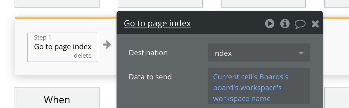

So this is the workflow I’ve put into place for when “Group sidebar Workspace Projects Boards” (text parent group’s Boards’s board title) is clicked.

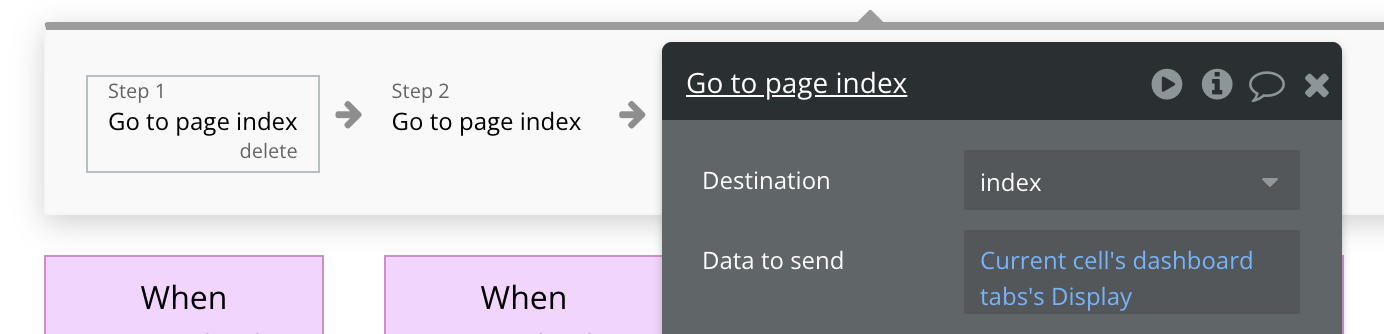

When tested I can see it sending to the URL as expected, although it’s conflicting with another current workflow I have for sending data to URL for sidebar tabs and subtabs, as outlined below:
Tabs:
And their Subtabs:
Although I think this is probably the culprit…
I’m not sure what expression would be needed to keep these workflows applied to only the sidebar tabs/sub tabs, and not to interfere with sending the Workspace to the URL. Any ideas?
