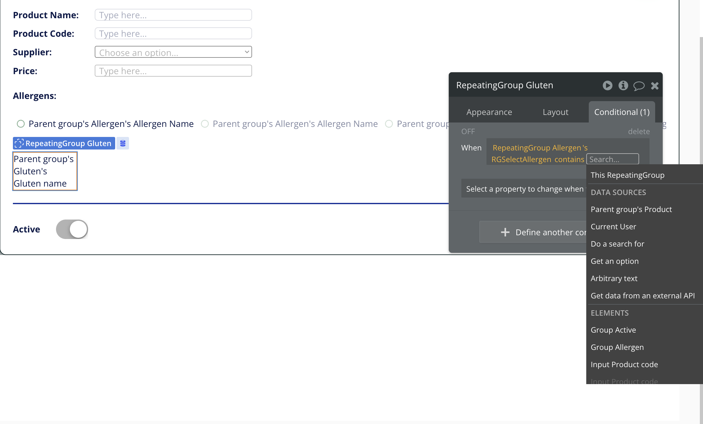

Hi, I’m in need of help… Relatively new to Bubble, I’m creating a pop-up with a repeating group (the “Allergens”). Now I want the second repeating group (highlighted in red) only to be visible when the value “Gluten” is checked.

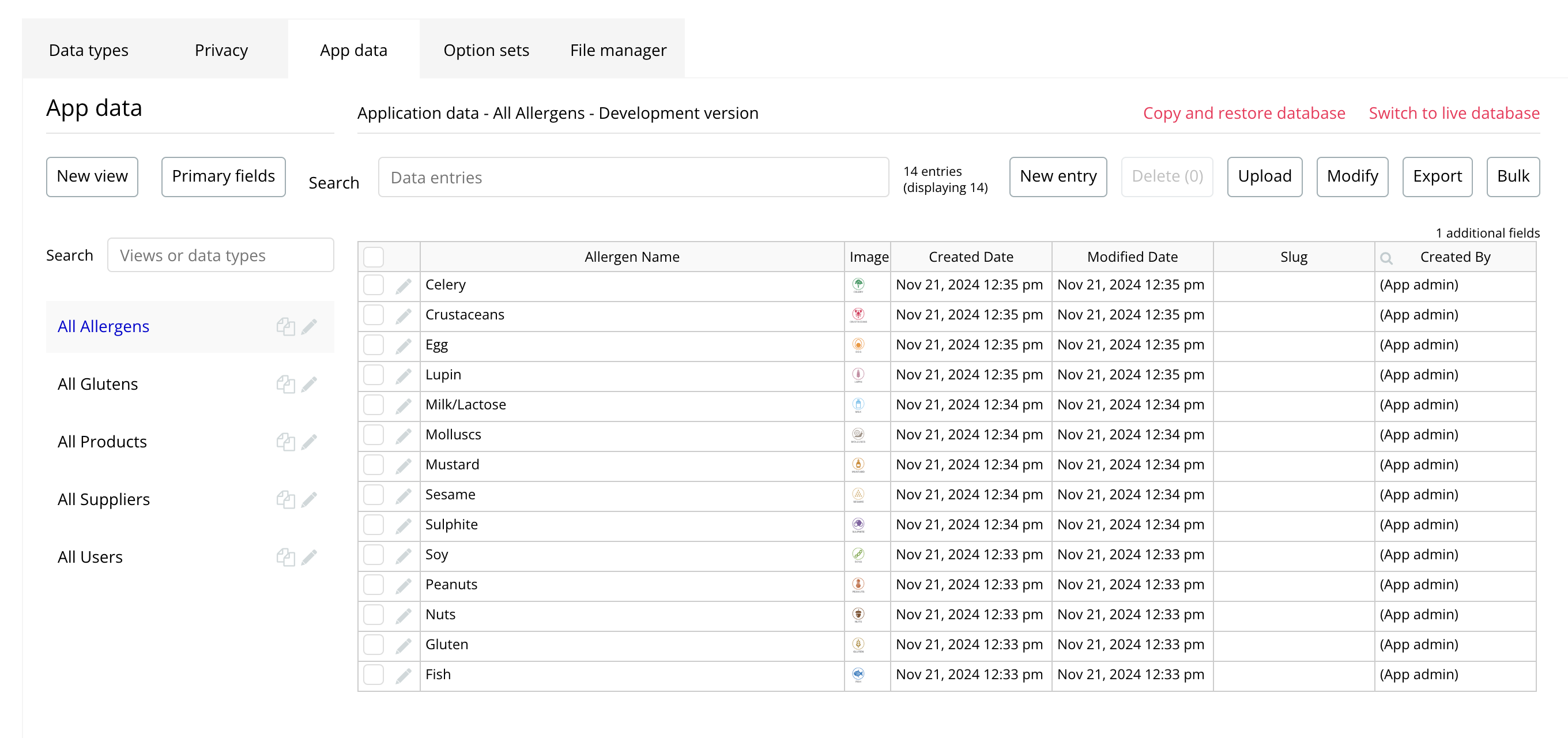

The allergen data is app data and not an option set.

My biggest question mark is how do I refer to the “gluten” in the conditionals to activate/make visible the second repeating group? Multiple checkboxes might be highlighted, but only when gluten specifically is highlighted, the second RG should be visible.

I have created the state on the first repeating group, I’m now going to the second RG’s conditionals, i’m referring to the state but then what… ?
Really sorry, feeling so stupid…
You’re close!
Now use contains ''your option set'' 's values.

@GH5T that’s the thing… The data are not option sets. It’s app data. Should I be working with Option sets?
Either or works! :slight_smile:
You just have to build with “dynamic” names/items in mind.
