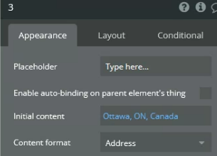

To clarify, my app take as input a location like a city or address input by a user (I convert the input address into lat and long using google API and I put that data into the database USER as a temporary position since the input can be modify at any time by the user). Then I want to display the distance of a list of several hundred of events around the input city (only straight line distance, no need to be accurate), which are in the database (lat and long as well). Right now I use the google API and it works perfectly fine but the cost is becoming to high… for instance if 100 users check events around a given position and If I have 100 events in the DB, it require 10K API call to google… :scream:
So I need to find a way to calculate that distance using a back-end workflow without using the google API (except for catching the lat and long of the user input). I saw only the Ultimate tool kit as a solution, but I don’t understand how it works (no doc available)… Also I though using Math plugin to make the calculation of the distance equation but acos, cos, sin algebra doesn’t seems to work… I kind of stuck right now… thanks a lot for your help :wink:
So I am not certain how fast your app will be (you will need to test), but you don’t need an API to do this. You can do distances inside of Bubble.
Try this. It’s front end, but I am sure you can figure out the back end version.
Interesting thx a lot, are you sure that is not using Google API some how ?
Well that’s a good point, try it out without a Google API key set up and see if it works!
So yes, they do use the Google API, because you would have put that into your app. But you do get a $200 credit every month from google, so that should cover a large amount of costs. Aside from that, you can always check out other map providers like mapbox.
Thank you @troy.roberge. So I finally manage to make calculation of the distances using Mathcalculator and a simplify equation assuming the earth is flat :wink: it works for small distance…
Then I went to my google cloud account and observe no difference in the API call… So I investigated for quite some time and observe that Google place API with the auto completion feature use to perform 5 API call for only 1 input… Also I observed that all calculation distances inside bubble are not passing by google once you have in the DB the location… which is a good news ! So I simply disabled the place API since auto completion will be too expensive for me if I have many users… and also the input geo adress works already well in bubble (allow typo…). Now I use only the Google Geocoding API and it works very well: 1 api call for 1 input, and all the distances are calculated inside bubble :grinning: Thank u again for your help !
