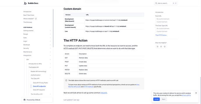

It does look like they have PUT and PATCH as well. Check it out: Data API endpoints | Bubble Docs

Thanks, J805. Will this work for the bulk calls as well?
For instance, if the endpoint ended in obj/rentalunit/bulk, would the PUT calls work?
Good question. I haven’t tested it with a PUT. It’s worth a shot. :blush: :man_shrugging:

It doesn’t seem to work for me. :man_shrugging: Seems like bulk create might be the only thing we can do. :blush:
