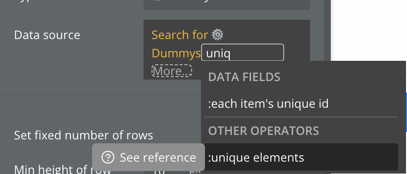

Try the operator :unique elements
At the Data Source add unique elements operator.

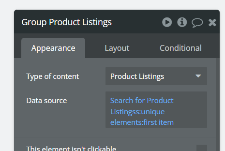

No that did not work.
That won’t work, you’re searching for the 1st product in your product list and not for unique brands.
