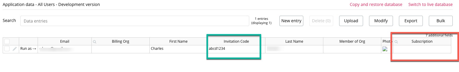

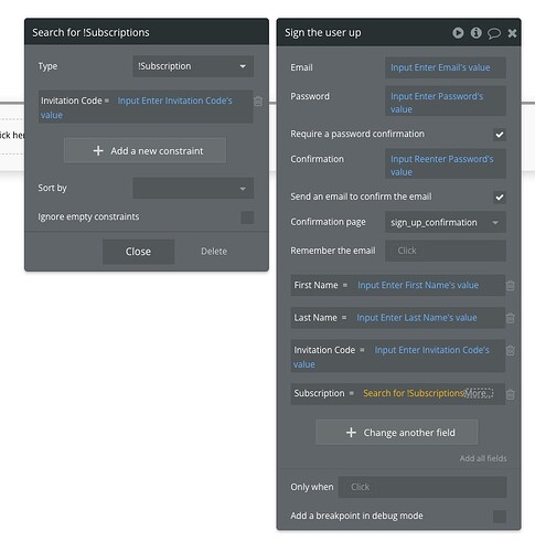

This should be fairly straightforward but I cannot get it to work. When I am signing up a user, I am asking them for an Invitation Code. This code should then check a table called Subscription and locate the Subscription that uses that invitation code. But I am unsuccessful. I have attached 2 screenshots which I hope clarify what I am trying to do. Basically, I am trying to assign the subscription name from the Subscription Table.
I did a search on the Subscription table looking for the invitation code.
Type=!Subscription
Invitation Code =Input Invitation Code’s value
I thought that would be sufficient, but I was getting an error (code in red), so I added the value “:first element” and it accepted it, but no value was returned in my Subscription Name field.
I hope I explained that clearly. Thank you for your help. Charlie
You need to specify an individual subscription (not a list of subscriptions), so just add First Item to the end of the expression,
Thanks Adam, I did try that (I said first element but meant first item). However, let me delete it all and try again with First Item. And thank you for the quick reply.
It was driving me crazy. I couldn’t figure out what I was doing wrong. By chance I noticed the privacy on the table was private… lightbulb. It’s working now once I made it publicly visible. I’ll have to change that, but now is probably a good time to learn about privacy/security. Thanks again.
