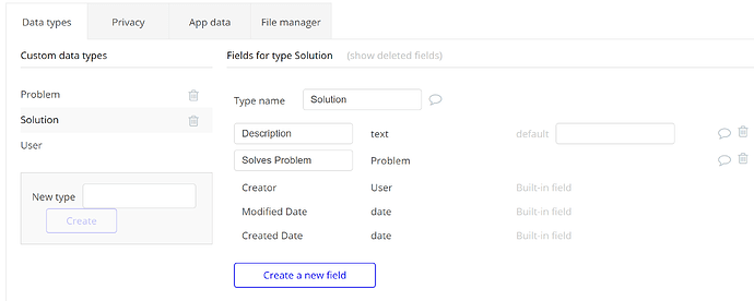

Simply put, in your database, a Problem must have some sort of relationship to a Solution (or perhaps even a list of Solutions) that answer/solve that particular Problem. In this way, you can (regardless of the user interface you come up with) match a Problem with its Solution.
There are many many different ways you might structure these objects, depending upon what this feature you’re building is.
Regardless, I’d recommend creating a Problem as its own datatype and, at a minimum, it would look like this:
