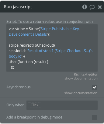

I’m implementing a Stripe Integration I have implemented in numerous other applications.
I am implementing it in the same exact way. Part of the implementation is to use the Run Javascript workflow action to direct a user to the Stripe Connect Page using the below approach
Screen Shot 2021-08-12 at 6.39.42 PM
All details are correct in the dynamic expressions, however, I always get this error and I’m not directed to the Stripe checkout page
Screen Shot 2021-08-12 at 6.39.29 PM
@mishav does this error code mean anything to you? I’ve tried everything I could to figure out how to resolve it, including changing the dynamic expressions to static values, and nothing seems to work.
Has anybody else experienced issues with the plugin recently?
This looks to me as though the Stripe library is not loaded at the point at which this script is executed. Stripe() should become a defined constructor method once it is. How are you loading the Stripe library into the page?
Have you tried wrapping it in an jQuery document ready event? (Though this only really makes sense if you’re executing the above during initial page loading…)
$('document').ready(function(){});
Otherwise checking that the library is pulling down correctly would be my second test.
Thank you @exception-rambler for the insight. I kept thinking the Stripe()reference in the error code was referring to my dynamic value used for the publishable key. Completely forgot about the script on the page.
Just added the script to the page using an HTML element and it is working now.
