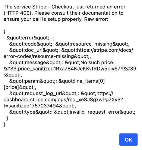

I just tried to test live Stripe payments (using Bubble’s API connector) and I got this error message:
Does anyone know what the issue is and how to fix it?
It says no such price, that means in stripe you may have not added that price yet or if your added you may have added in test mode or live mode in the testing in either of those modes, ie modes mismatch
