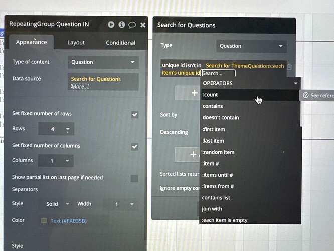

Hello Ahmed,
Thanks for tour support but it doesnt works
Thanks for sharing the screenshots.
So you have your data type “QuestionTheme” to store questions related to themes.
in your “RG-QuestionOUT”, you can set the Data Source = “Do a Search for Questions Where Unique ID isn’t in Do a Search for QuestionTheme:each items’Questions’Unique ID Where ParentTheme = “Dropdown Choix de Thème’s value” "
Hope this helps !

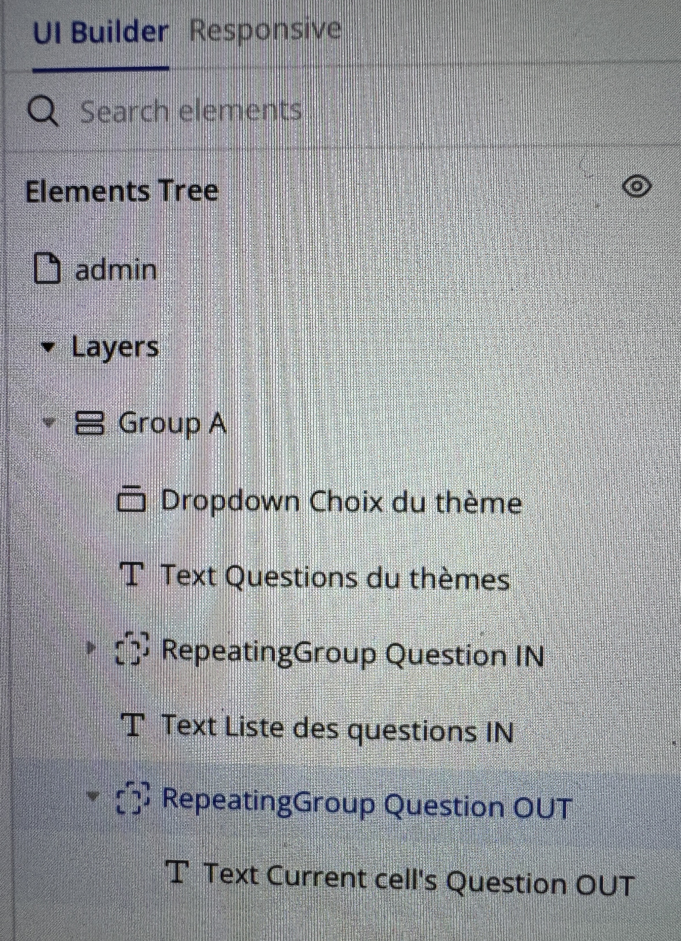

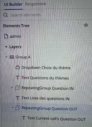

Hello,
Thanks for your Help, I have a Little problem
I did the édit on the wrong group but its the same)
So the result is what you expected ?
Yes Thanks a lot !
