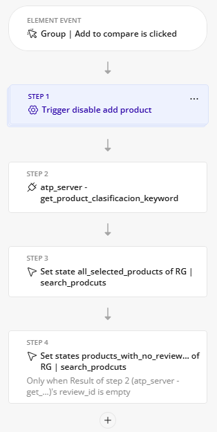

I have a workflow that starts by clicking an “add button”.
  1. Step 1, adds a value to a state list.
  2. Step 2, make an API call.
  3. Then other stuff.
The intention was that products in that stat list would not be clickable once added.

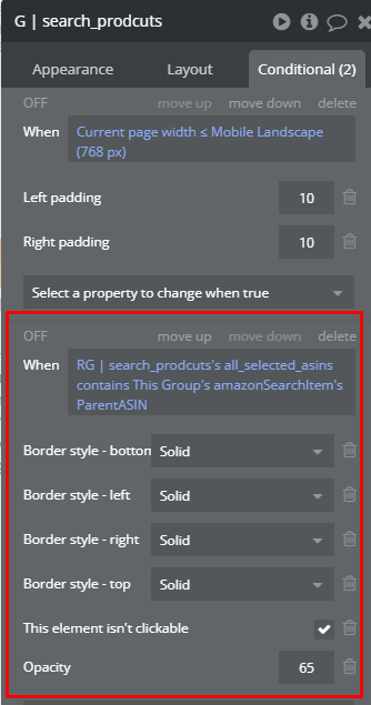

So I made this conditional statement:
The conditional rule executes only after the workflow completes, processing each “add click” sequentially, which slows down the process due to the API call involved:

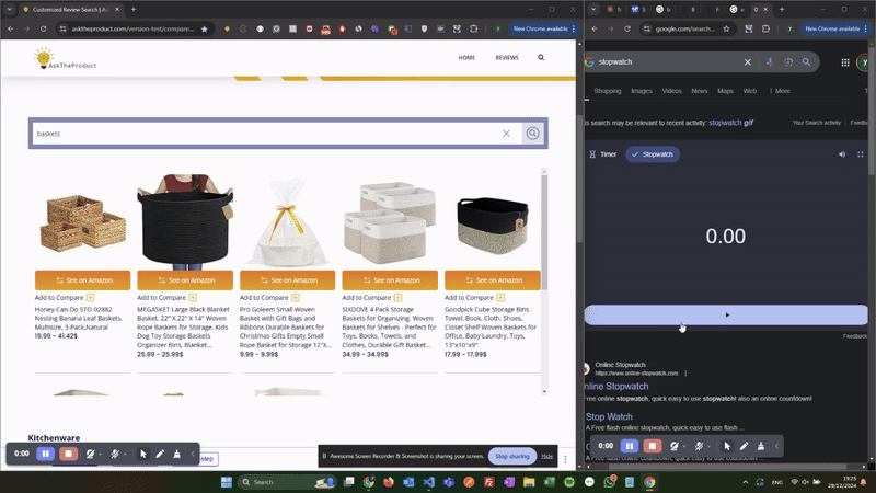

ezgif-4-2bdb77caae
How can I make the conditional rule execute immediately rather than waiting for the rest of the workflow to finish?

If goal is to make something not clickable while you process something, on click set custom state to a yes value and have condition for thing to not be clickable when custom state value is yes, then have action to set custom state value back to no after processing has finished.
I’m doing something like that.
On click it adds the product card ID to a custom state list.
The card has a condition that it’s not clickable if its ID is in that list.
But it doesn’t execute until the API call and the rest of the steps in the workflow are finished.
Which makes the UI delay look very bad.
put that first action to set state into a custom event which should force it to run and complete before other actions run
In a workflow with two actions, if Step 2 is using a condition based on a search depending on data manipulated in Step 1, then Step 1 should be implemented into a custom event to make sure it is finished before moving on to Step 2
It still processes everything synchronously…
