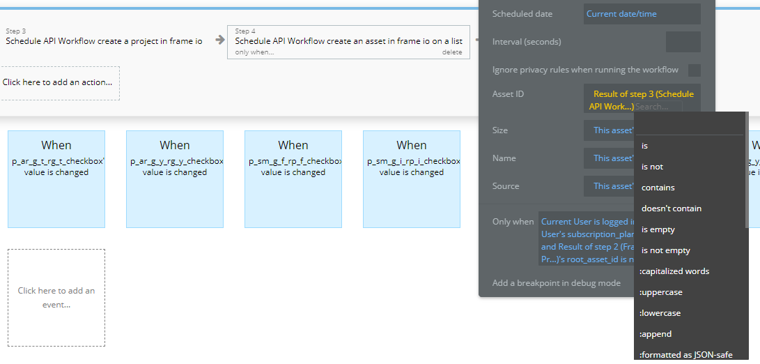

I’m working with Frame.io’s API. In my bubble app, I created a backend API workflow that uses Frame.io’s “Create a Project” call which I will schedule to happen at various points through the app.
I want to be able to reference the API’s responses, like the project’s “ID”, etc, but whenever I schedule this workflow and try to reference it dynamically, the only result is “Result of Scheduled Workflow” or something like that.
How can I reference the responses of an API call from a backend API workflow?

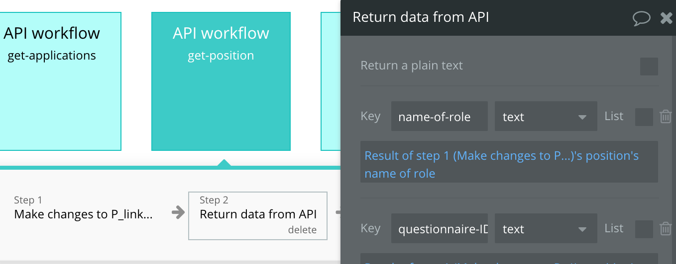

This might help you find it. The clue is to access the results from the API call in the previous action step.

I know how to reference results in a previous actions step. My issue is that the results from the API do not appear. My only options are "Result from Step #(Schedule API Workflow).
I notice you have a “Run” action for Step 1. I dont see that option. Could that be it?

When you create the API you explicitly say what it will return. The reason “Run” is prefixed is that this is an action (not data) API. For example
Right.
So when I did that, and then on another page I attempted to schedule the workflow, I still could not reference the responses. It only works when I’m in the API workflow page, but when I schedule the workflow on an entirely separate page or reusable element, I still do not get the options.
I may be missing something.
