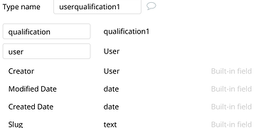

I would create a relationship datatype and then use it as my data source. Here, if you prefer, you can use the field creator instead of duplicating the field user:
Then, you can use “is in” instead of “contains”:

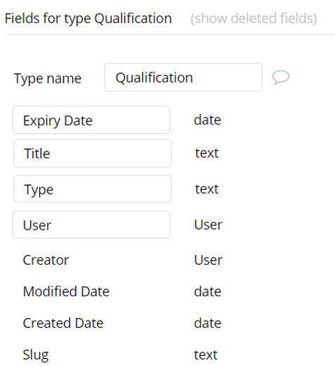

At the moment my User’s have Qualifications linked back to them as per the screenshot below.
Are you suggesting that I create a new Thing “UserQualification”?
Forgive my ignorance, but I’m not sure how that would work, considering I’m trying to use the expiry date as a filter in the repeating group.

Yes, you understood correctly, create a new thing called “UserQualification”. It is going to have the User (or Creator) field linked with the “User” datatype and the Qualification field linked with “Qualification” datatype:
PS - Here you will need to change how do you save the users qualification in your workflow.

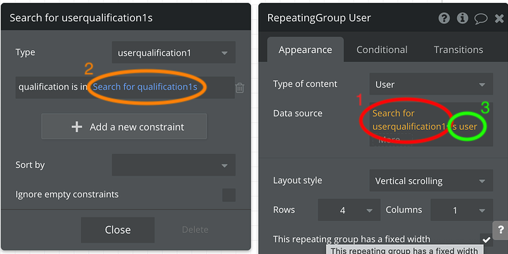

Then you follow these steps:
1st. Type of content will be “User” however the Data source now will be “UserQualification”:
2nd. You will filter the Qualification value that “is in” the results of the “Qualification” search, here you will apply the Expiry Date filter.
3rd. After that you will display the User’s field result of the “UserQualification” search.
