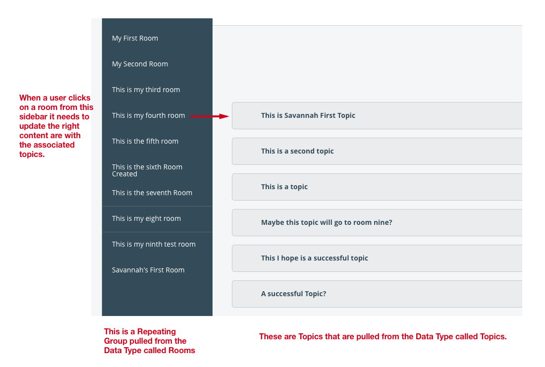

Hi! I’m loving Bubble. I"ve been using it to build out an MVP for the last week or two. Everything is making sense and progress is smooth, but I’ve hit a WALL when it comes to trying to display associate data based on whatever room a user is clicking on. I will break it down for you:
1.) I have a RG (as a sidebar) that has a list of Rooms that a user has created.
2.) I also have a RG (the main content area of the page) that has a list of Topics that a user has created. When they create a new Topic they can associate that Topic to a Room.

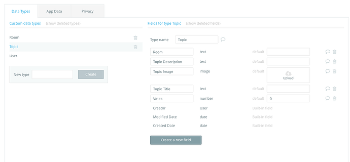

3.) The Database is set up as follows: 1 Data Type contains my Rooms (title etc). I have another Data Type that contains the Topics (with an additional field type called Room) this addition filed type populates with the appropriate room name once the topic has been posted. So all of this is working fine.
Where I’m stuck is creating the appropriate workflow that actually displays the correct topics for a room that is clicked.
Another way to think about this is: A category that contains a number of posts. How do I display the appropriate posts for any given category.
I’ve also attached a screenshot to help:

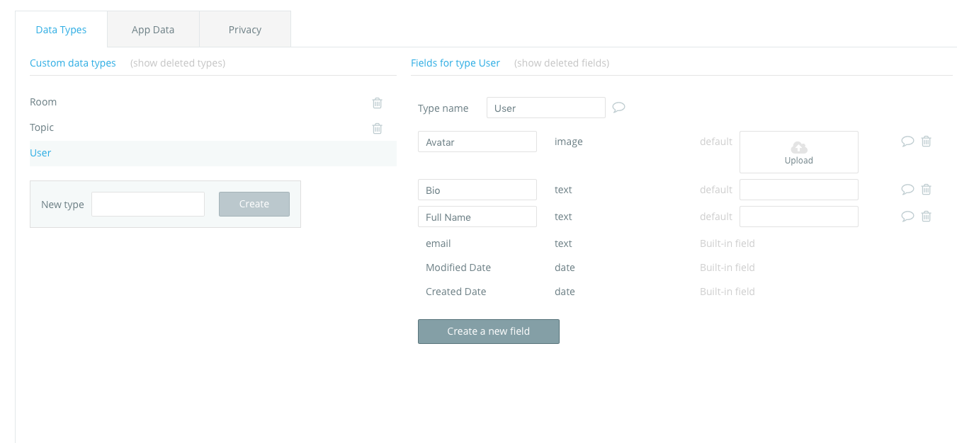

P.S.: Data Types/Structure:
@gf_wolfer Note that I have reposted the above (since I year the forum had to be restored). Thanks for your help so far.
In your Topic data type, try setting Room to type Room, rather than text. Then for the constraint you posted above: “Room contains Current Cells Room”, using = rather than contains should work.

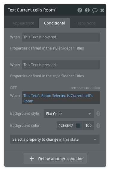

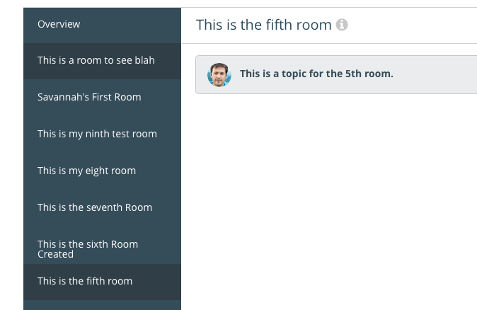

Thanks @louisadekoya so yes, that sounds like the same thing I’m trying to accomplish. I’ve attached a screenshot of what’s happening right now: I have a conditional set up that is like the following:
Now because of that, it’s activating that each time someone clicks on a new RG cell. SO I’m getting the following effect (Two rooms look active):
What I would like to do is only have the “room” I’m on be active. Will the steps you mentioned above work? If so do I then need to remove the Conditional I have already? What is also not on this is an Icon that I want to include that would delete this Room. I suppose I need to add that on the “Active” state as well or as an Icon that displays when a room is active.

It looks as though your custom state is on the text box? I don’t think that should be the case. Try this:
  1. Create a custom state of type Room on the repeating group. Call it active_room
  2. Put a button in the cell and make it transparent
  3. Put a workflow on the button with a “set custom state action” in it that sets the repeating group’s active_room to the current cell’s Room
  4. Set the text box’s condition to when the repeating group’s active_room is Current cell’s Room, then set the property as you require.
