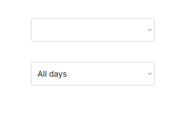

If you’ve ever used Bubble’s native dropdown, you’ve probably run into this annoying issue:
After selecting an option and then clearing it, the placeholder disappears — leaving a blank, confusing field.
This can hurt your app’s UX, especially in filters, forms, or search components where clarity is key.
So I created a simple plugin that solves this exact problem — and it’s 100% for free.
Just drop it into your app, insert dropdown’s ID, write the placeholder you want and it will behave the way it should.
Here’s how it looks without the plugin (top) vs with the plugin (bottom) for a dropdown listing the days of the week:
