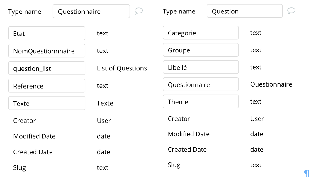

I have two tables: a questionnaire table and a question table.
image1078×624 65 KB
As you can see, in the questionnaire table, I have the list of questions that will be used to filter my questions according to the questionnaire.

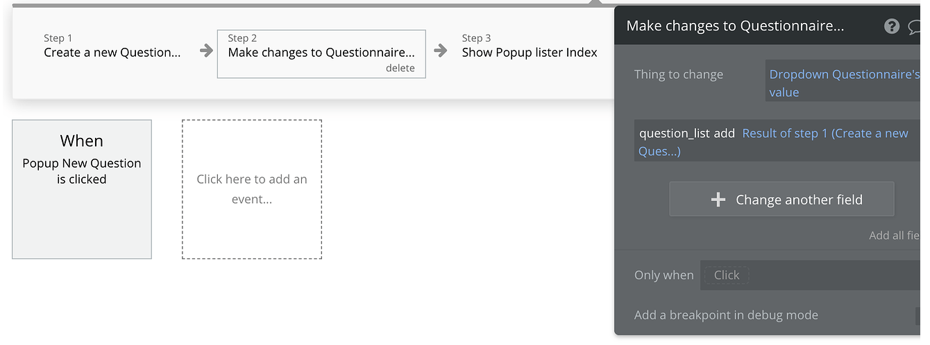

Unfortunately, instead of saving the index of my questions in my list, I save the index of my questionnaire.
I show you how I set up my workflow.
Creating my question record
updating the question record

Hi Cristian!
As I saw, after you create a new question, you add this question to the question’s list of the selected questionnaire .
It is not working? What is the issue?

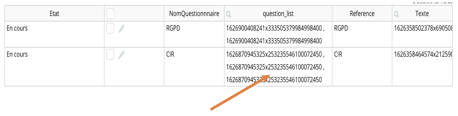

As you can see, below. I show you the content of the questionnaire table.
In the field “question_list”, I should have the index of the questions. But instead, I find the indexes of the questionnaires.
I would like, by selecting a questionnaire, to view the questions of this questionnaire

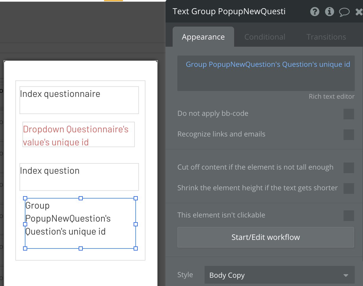

Thanks to rpetribu who found my mistake
I take back his message.
<<Found the problem. Everything was correct. The problem was that, in your database, you selected to display your questions using it’s questionnaire’s uniq_id instead of use the question’s uniq_id.>>
image|autoxauto
Changed to “uniq_id”. So you are good to go!
