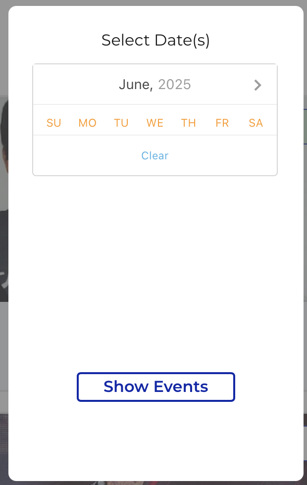

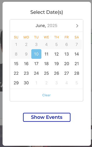

Hi @ZeroqodeSupport ,
I’m getting a repeatable bug using the “Clear” button on the calendar. When I click clear, then exit out of the popup that’s holding the calendar, then open the calendar again - the dates are not displaying.
1: Open popup with calendar
2: Clicked clear, closed popup, opened the calendar again:
3: Clicked clear again, closed then opened popup again:

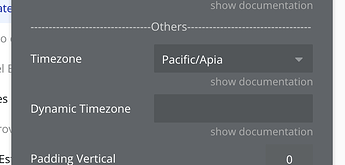

It seems that the current timezone configuration is not working at all. I have tried both using the dropdown and writing several timezones in the input and none of them change anything.
Please be aware I am placing several date/time picker elements on the same page, in case this could affect the functioning (I want all of them to have the same timezone anyway).

We’ve tested timezone changes on our demo and a fresh test page, and the picker behaves correctly with timezone management: https://seanhootsdemopro.bubbleapps.io/version-test/datetimepickerdyntimezone.
A common cause when it appears “not working” is that the page isn’t reacting to the timezone change. The picker exposes a change event, and you need a workflow that updates the displayed date/time when the timezone changes. For a smoother setup, we recommend storing the selected timezone in a custom state and using that state to drive the picker/value updates.
Please review the timezone section in our docs (https://docs.zeroqode.com/plugins/air-datetime-picker#4fa3c235db744194b799cf16deb99b68) and compare with our editor example to see the exact configuration and workflows:
Seanhootsdemopro | Bubble Editor
If you still see the issue, could you share a short screen recording and screenshots of your picker’s properties + the workflow that runs on timezone change? We’re happy to help you align the setup so all pickers on the page use the same timezone consistently.

Hi @jesuan94,
We’ve consulted our dev team regarding the plugin, and here’s our response.
When you set a specific timezone in the picker (such as “Current user timezone”), the plugin will return the correct time for that timezone. However, after you save the selected date to your database, Bubble itself stores this value as a universal timestamp (UTC). When you later display this value in a text element, Bubble automatically shows the date and time according to the viewer’s current browser or system timezone—unless you apply custom formatting to force a specific timezone.
To see exactly how this works, you can try a quick experiment. Save a date using the picker with “Current user timezone” selected, store it directly in your database (with no extra formatting or conversions), and then display this value on a page just as it is. If you then use a browser extension to change your local timezone, you’ll notice the displayed time updates according to your new timezone. This is standard Bubble behavior, and it’s not specific to the plugin.
If your goal is to always show the time in a fixed timezone, regardless of the viewer’s location, you’ll need to use Bubble’s :formatted as operator and explicitly set the timezone in your text element. On the other hand, if you want users to always see the time in their local timezone, you don’t need to apply any additional formatting.
It’s also worth noting that using multiple pickers with the same timezone on one page should not cause any conflicts.
For more details, you can refer to the Air Date/Time Picker documentation and this helpful forum thread.

Hello!
Thank you too for your detailed reply. I think I understand it but I am not able to find out how to configure this use case (or whether it is possible):
  1. I have user A in Brazil who wants to save a given hour and minute (using time picker) in a different timezone (let’s say Spain). Ex. I am in Brazil and select 10:00 in the picker, I want this to be saved in database so that it corresponds to 10:00 Spanish time
  2. Now if an user from Spain opens the page the picker will display 10:00 so that is correct, nice
  3. Now, what about the user from Brazil? The picker should display 10:00 to him too and not 06:00 (4 hour difference)
Is this possible? Basically I just want that the time shown in picker is always Spanish (or other dynamic selection), but it seems to me that at the moment the data is processed twice (once when saving, another when displaying) and I cannot find an option to avoid the second part.
Thank you in advance
Hello @jesuan94 ,
Here’s how you should do it:
  1. Set the picker’s timezone property to "Europe/Madrid" (Spain).
  2. Prefill the picker’s value with the saved date from your database, but use :formatted as to explicitly set the timezone to Spain:
    Database thing's date:formatted as (Europe/Madrid)
Result:
  • A Spanish user will see the correct date/time in their local (Spanish) timezone—no adjustment needed.
  • A Brazilian (or any other) user will also see the date/time as it would be in Spain (not converted to their own timezone), because both the picker and the prefill value are explicitly set to show the Spanish timezone.
This setup forces all users to interact with the time as it exists in Spain, regardless of where they’re located.

the Air Date/Time Picker applies the timezone override only when saving the value, but it does not apply the override when displaying the initial value. This is because the element is treated strictly as an input, and Bubble’s input behavior prioritizes the browser’s local timezone during display.
We’re glad to hear that the regular Date/Time Picker fits your use case for now. Your findings are valuable, and we’ll make sure to pass this idea to our dev team for review. That said, we can’t promise an implementation or provide a timeframe until they evaluate how feasible the change is across all use cases.
