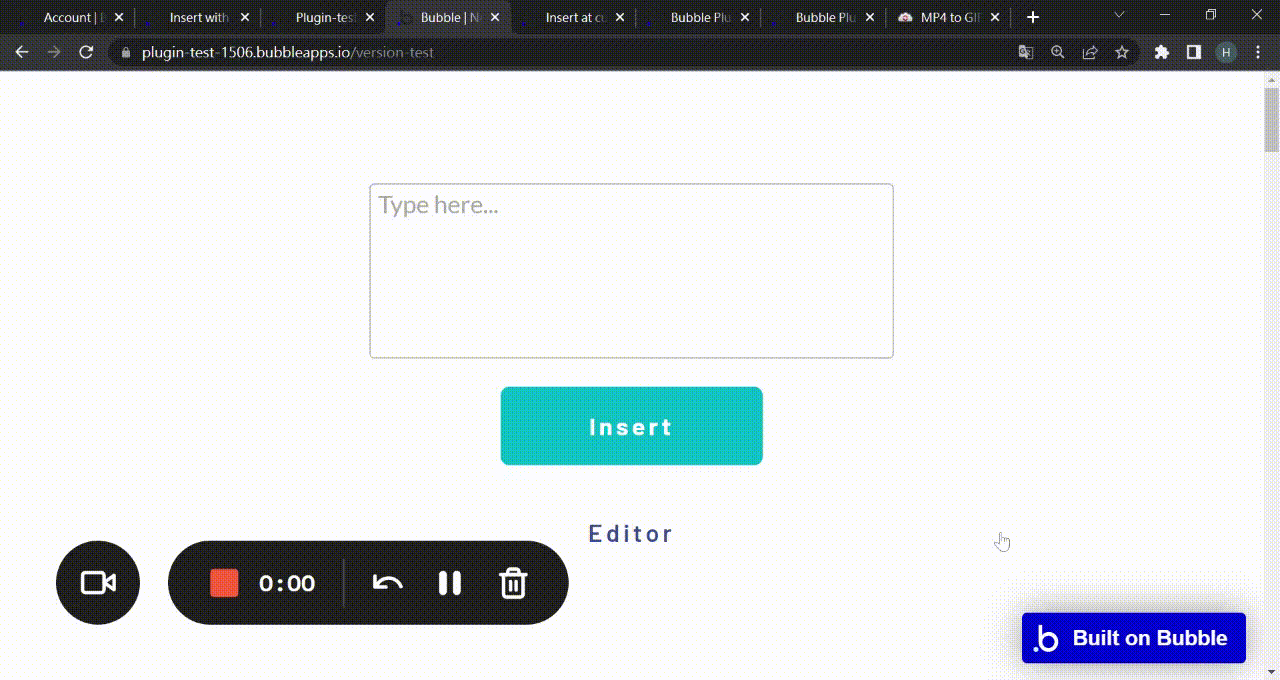

Hello Bubblers,
I made a plugin based on the plugin built by JC Massé (Insert at cursor position Plugin | Bubble).
This is a simple action to insert text to an input element. I have edited the code and added a typewiter effect to the original plugin.
Bubble _ No-code apps - 22 June 2022 (1) (1)
To use the plugin:
  1. Go to Settings > General > Expose the option to add an ID attribute to HTML elements: Check the box.
  2. Add an ID attribute to the input element
  3. Add the action. Text field Attribute ID = the input element’s ID attribute.
