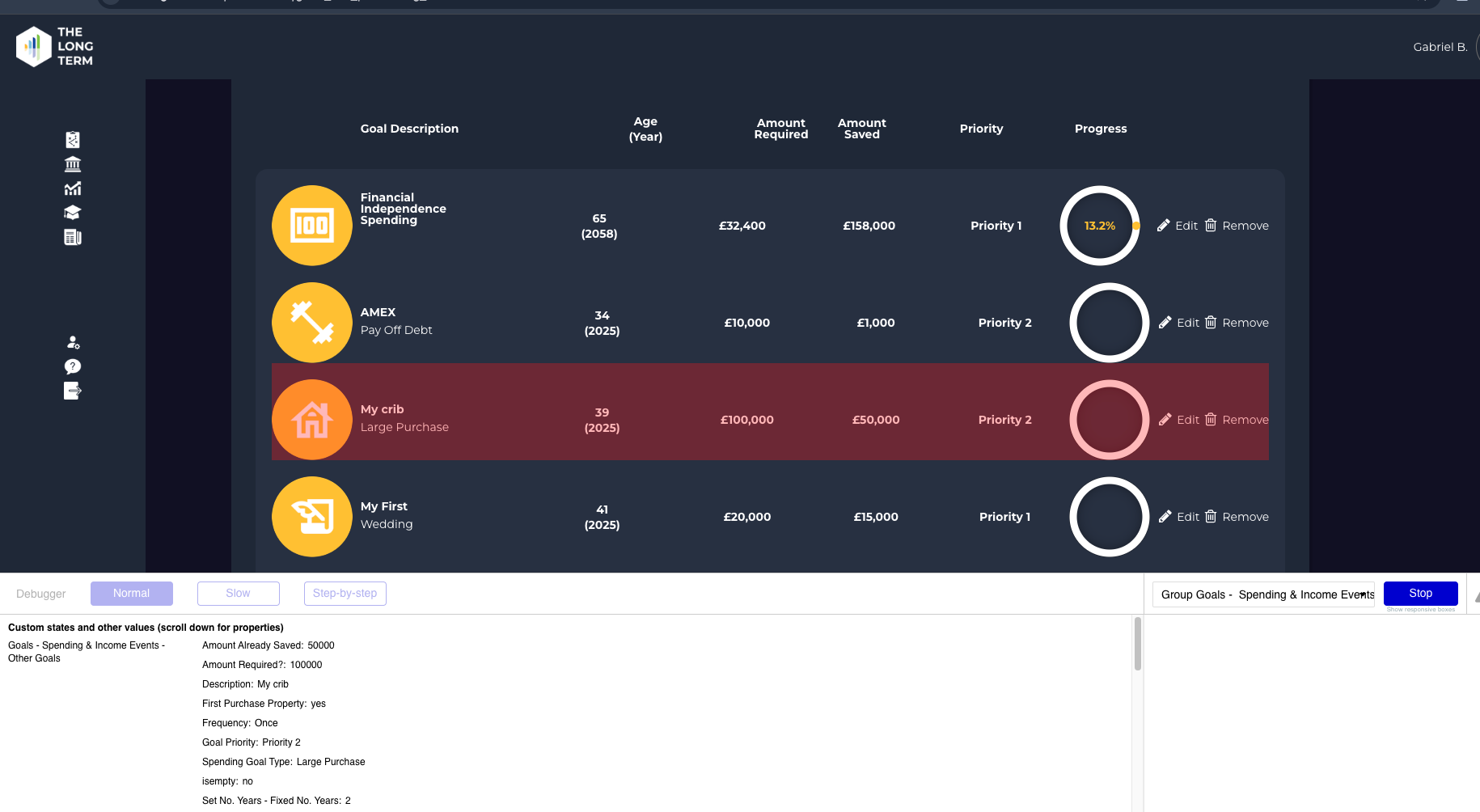

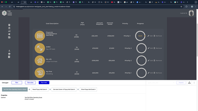

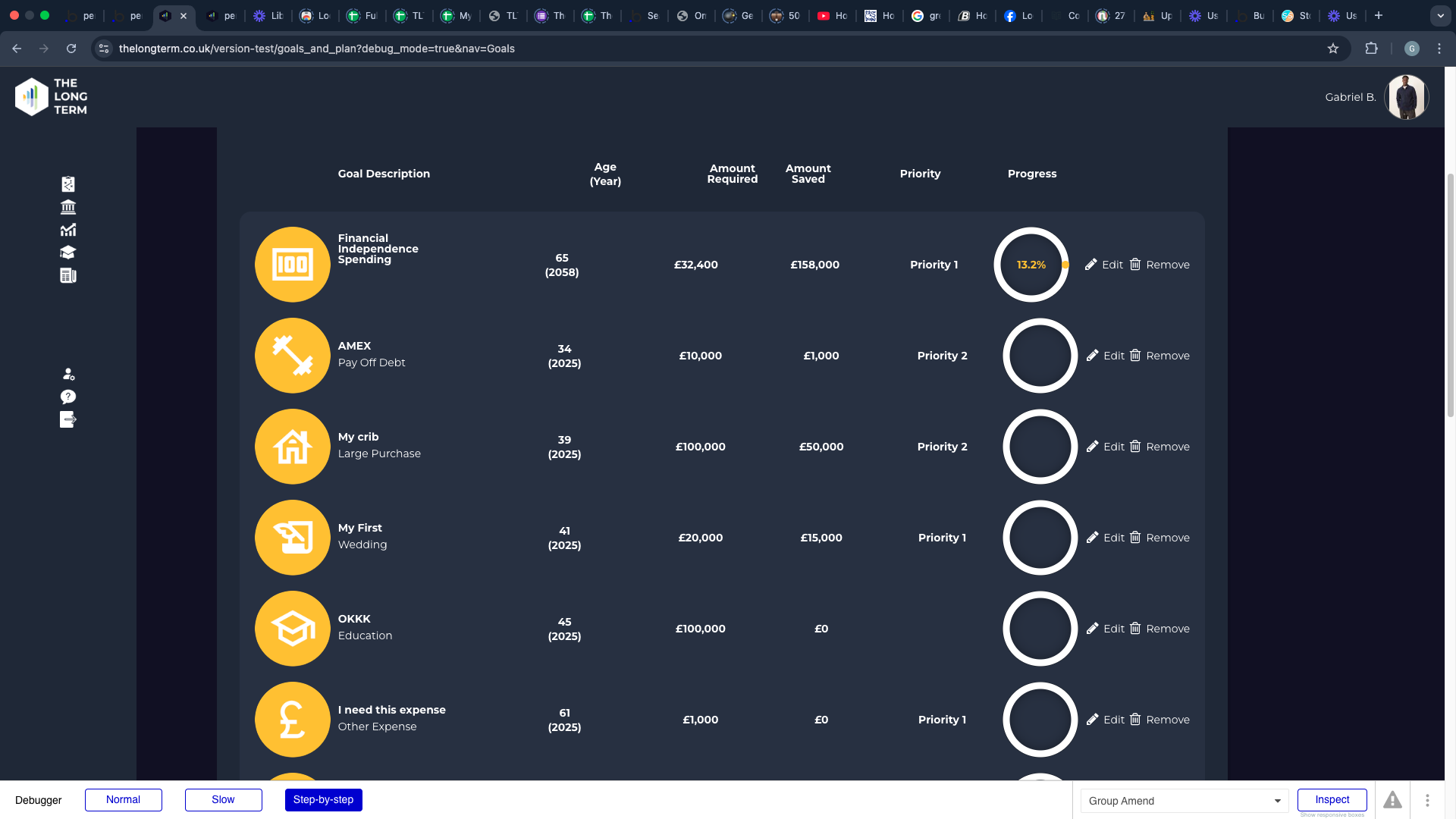

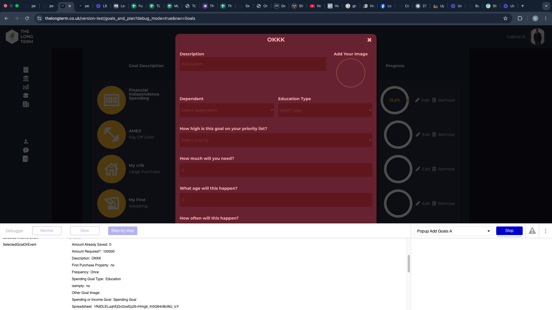

Users can add goals and income events using the Popup. They can do that for all four data types. The saved goals are shown on the goals page. Because the other goals have a one-to-many relationship, I use a repeating group to list all goals. However, when editing the Other Goals, the data is not passing from the repeating group to the Popup add goals when the custom state is “Fill”
If someone could let me know what i’m doing wrong, I would appreciate it.

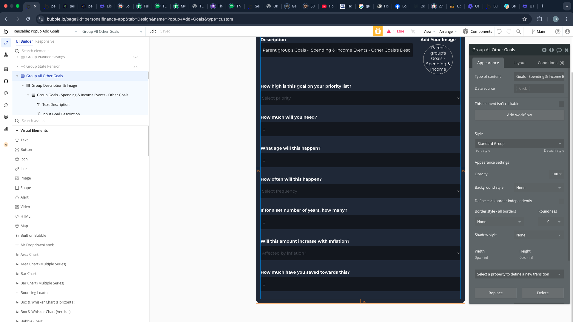

If the data is correctly populated at the popup level but not in the input inside it, there might be a missing link when cascading the data from the popup to the input. You might want to to check the value of the input’s parent group and tracing the data cascading to the next parents until you’re certain it’s connected to where the data is set in the popup (in the popup’s custom state?)
