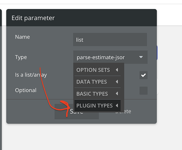

This post hits hard. It’s impossible to do the following in the backend:
  1. parse JSON to get lis
2. run recursive/loop workflow on list
since there’s no option to get “PLUGIN TYPE” as a param type on backend workflows. I’m forced to perform recursive workflows on the front end via custom events (image below)/
This is terrible since if user moves away from page the process will fail.

If I understand you - I use the JSON Assistant and I can do this in BE workflows. Check it out, $14 to not have your problem is money well spent.
