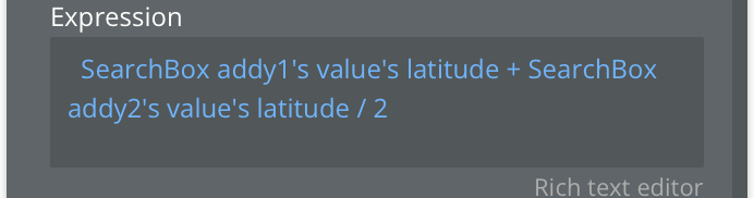

Easy (I think).
Create an Expression, whose numeric value is:
Create another Expression, which numeric value is:

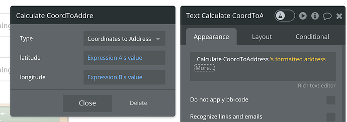

You can calculate the addy between them as follows:
I tried this a couple of times and it seemed to work.

What you are trying to do isn’t exactly Bubble 101-level stuff, but it IS pretty basic.
You need to start off implementing the Google Maps plugin into your app, then your search boxes can use geographic addresses as search values.
There is a good video on YouTube that explains implementing Google Maps:
And here is a pretty decent video on latitude and longitude usage:
