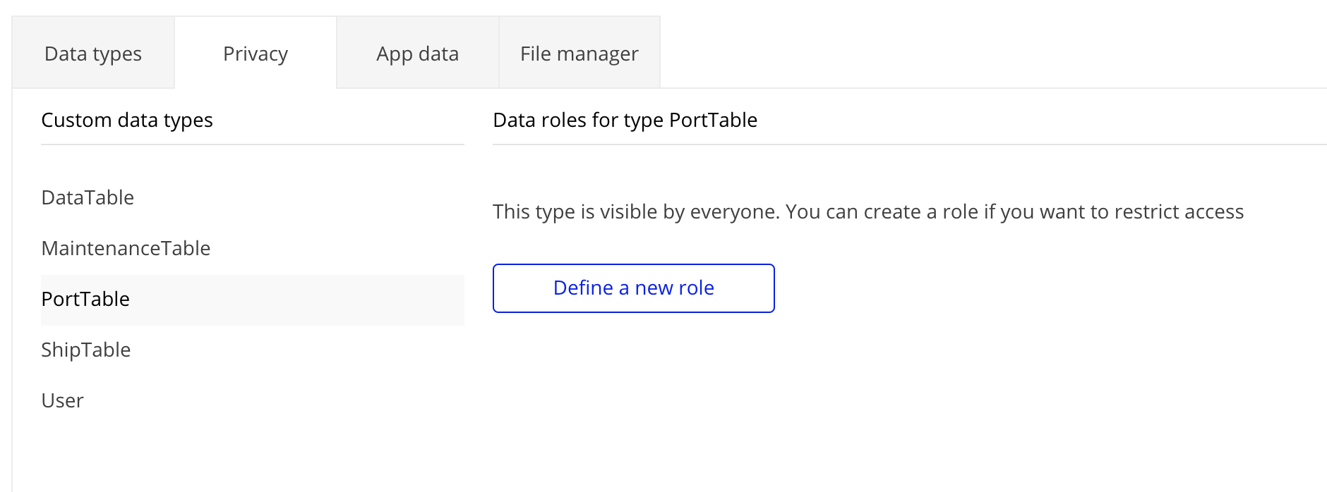

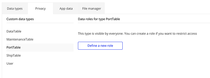

I’ve attached a screenshot:
The only things I can think of as potential causes: lacking data in Live version of app, conditional statement on your repeating group is not returning the search query correctly, or data privacy roles on PortTable or ShipTable is preventing search results from appearing.

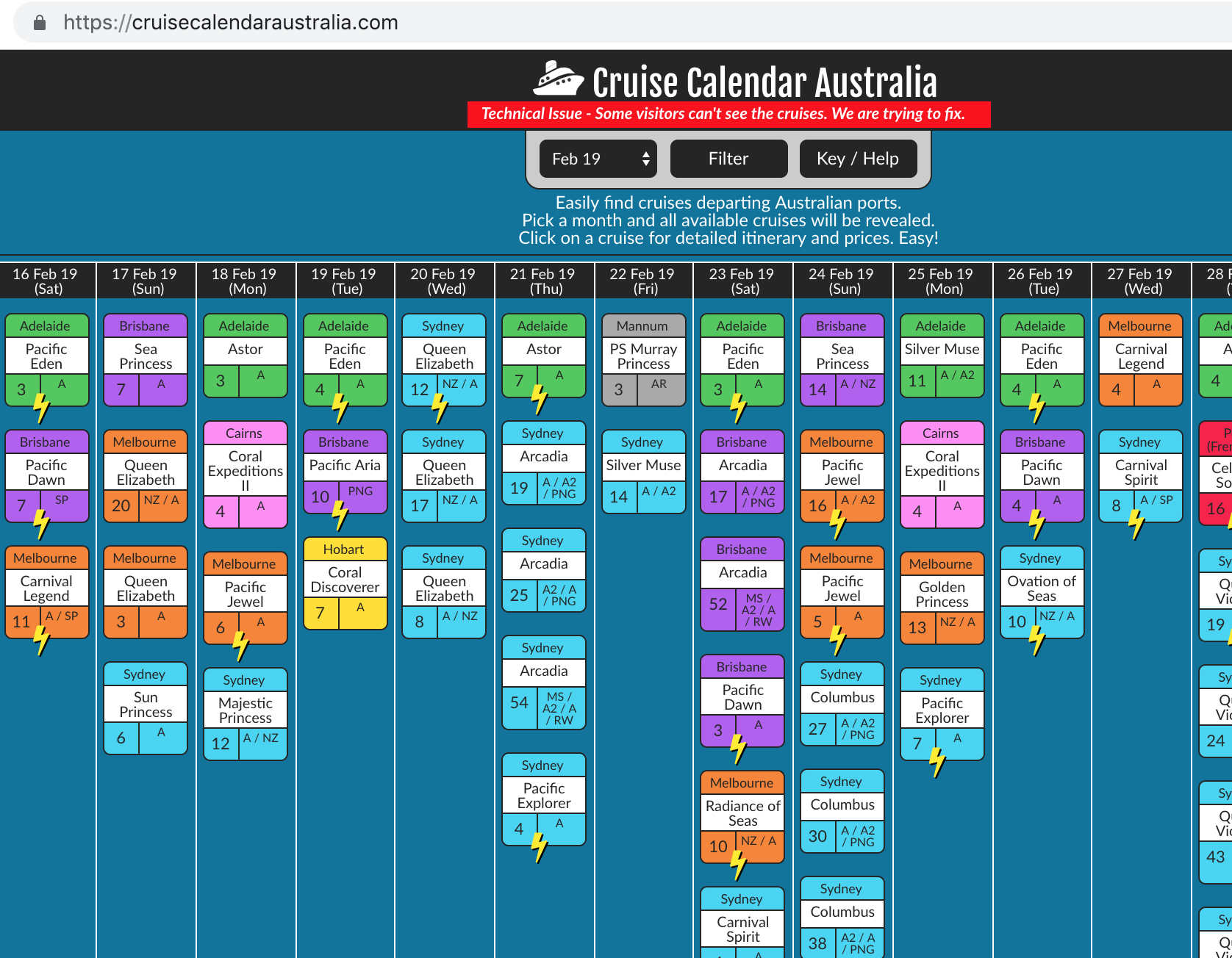

I have data in my LIVE DB…here is a screenshot of the live webpage. The RG data source seems to be hooked up correctly. But for some reason, not everyone on every platform can see it populated.
@inga Ok, then this seems to be a data privacy issue.

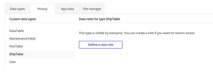

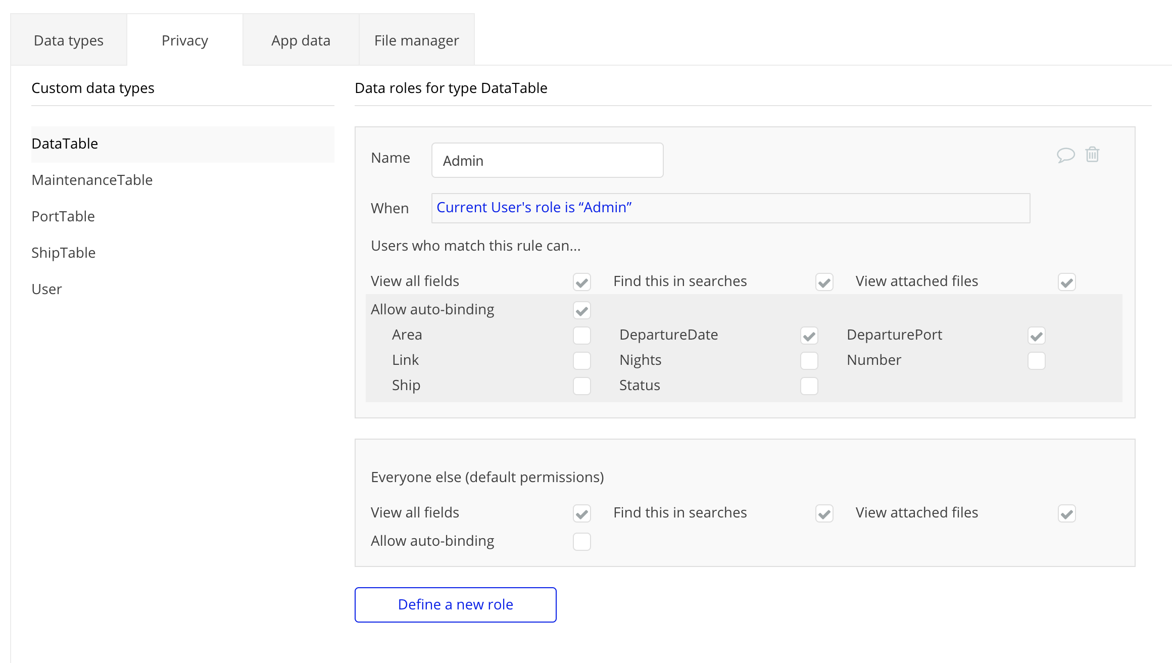

Please upload screenshots of your privacy settings for users, and all the tables related to the cruises.
Here you go. Thanks @Nocodify
Do you have any privacy settings for “User” @inga ?

It looks like your repeating group is set up correctly, but all the conditions on your groups are affecting the data from displaying. I’d take a look at all your conditions to make sure they are set up correctly.
For example:
For this data source, this group will always look at the first item in the Repeating groups list of data tables, no matter the position of the cell in your repeating group.
Please take a look at your conditions and data sources. This isn’t a cross-browser issue.
Thanks for looking into it. I’m trying to get my head around the fact that the conditions and datasources that produce the results I want are not doing the same thing for everybody.
Do you think the current/date time mentioned in some of the conditions could be the problem?
I may be clutching at straws but could it have something to do with timezone as there seem to be many people outside of my timezone experiencing problems, and many people in the same timezone loading the webpage ok. Thoughts anyone?
