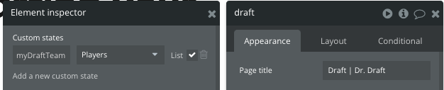

The state type is ‘Player’ (list):

@yamada.shoji99 if i set the state to type text, will i still be able to save it into my data base? I have a ‘Player’ data type and a ‘Team’ data type. A team is made up of a list of these players.
You cannot use a DB type for an API type. If you need a player name, this is a text, and list should be of type text. If you want to a cell of your RG, you need to set the state in the same type of your RG. Because current cell is of type RG data source. You can aave this to your DB with the value of this object.
Yes you can, create new thing then save the data e.g. Player = your state name
Thank you both! I refactored everything to change the states to a ‘Text’ and it seems to be working so far.
