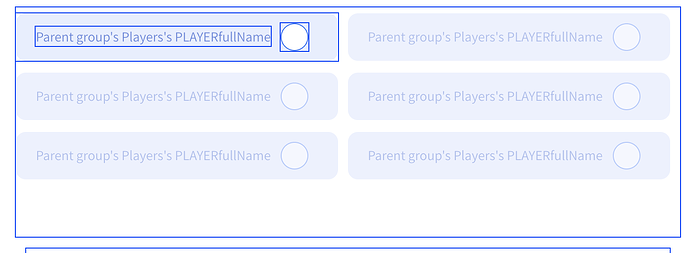

Hi all,
I need help managing two Data Types: Players and Tournaments.
The Repeating Group displays player names from the Players data type.

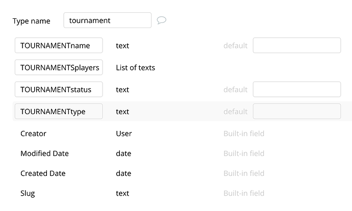

When a user selects players via Ionic Checkbox, their names should be added to the TOURNAMENTplayers field (a list of texts) in the Tournaments data type.

  1. Change the data structure for tournament by removing the List of texts field for players and make it a field that is a list of players (relational)
  2. Change the UI so you are not using the checkbox element and instead use an icon
  3. When the icon is clicked use an action to make changes to Tournament and change the Players field by ‘add’ and ‘current cells’ player’
