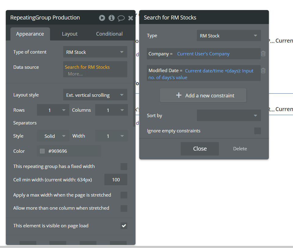

I have a RG wherein I want the data to be displayed based on modified date - no. of days as inputted by user.
How do I get this to subtract when the no. of days is based on an input field. I’m unable to out a minus sign in front.
Thanks
Deepak

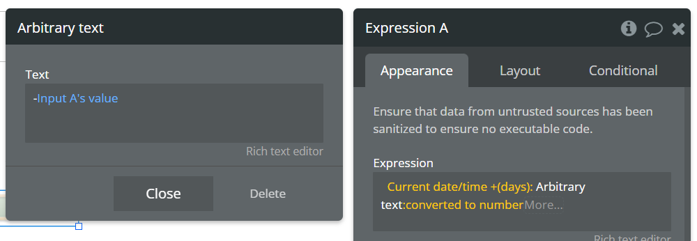

Hi! You can actually do this
Thank you very much for that quick solution Amos. Much appreciated!
If you have parentheses enabled you can also do Current date time +days (Input * -1)
Thanks a lot George!
