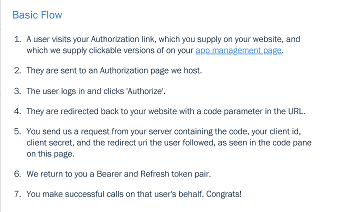

I’m trying to figure out this api… Can anyone help?
I’ve got steps 1-4 to work great. I just can’t figure out how to send step 5?? Should I be using “OAuth2 user-agent flow” or “OAuth2 Custom Token”? I’ve been banging my head against the wall for hours…

Thank you!!! This moves me in the right direction. So, one follow-up question:
On the black code-pane on this page, it shows 3 different ways to make that call (step 5)… Which should I use??
I’m assuming it’s the bottom one… IF it’s the bottom one, where does the "res = " section go in Bubble editor?
