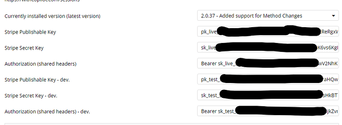

Could you tell me why I keep getting this?
I have my keys set up right but I keep getting this error :frowning:
What’s your client secret format in the plug-in tab? Send a mostly redacted screenshot (or screenshot it then just generate a new key from Stripe dashboard). Looks like the keys aren’t set up correctly.
