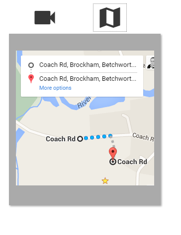

So… 4 months later and I decided to try to get this to work for a real project …
Google API is still a nightmare to navigate, so I think I need to understand that more.
But I enabled the “Maps Embed API” and that seems to work.
In terms of addresses, “Current Position” goes into the Origin nicely, but my stored addresses wanted the +street+location+town style format, so I switched to lat/long which may be more accurate for what I want anyway.
Result !
