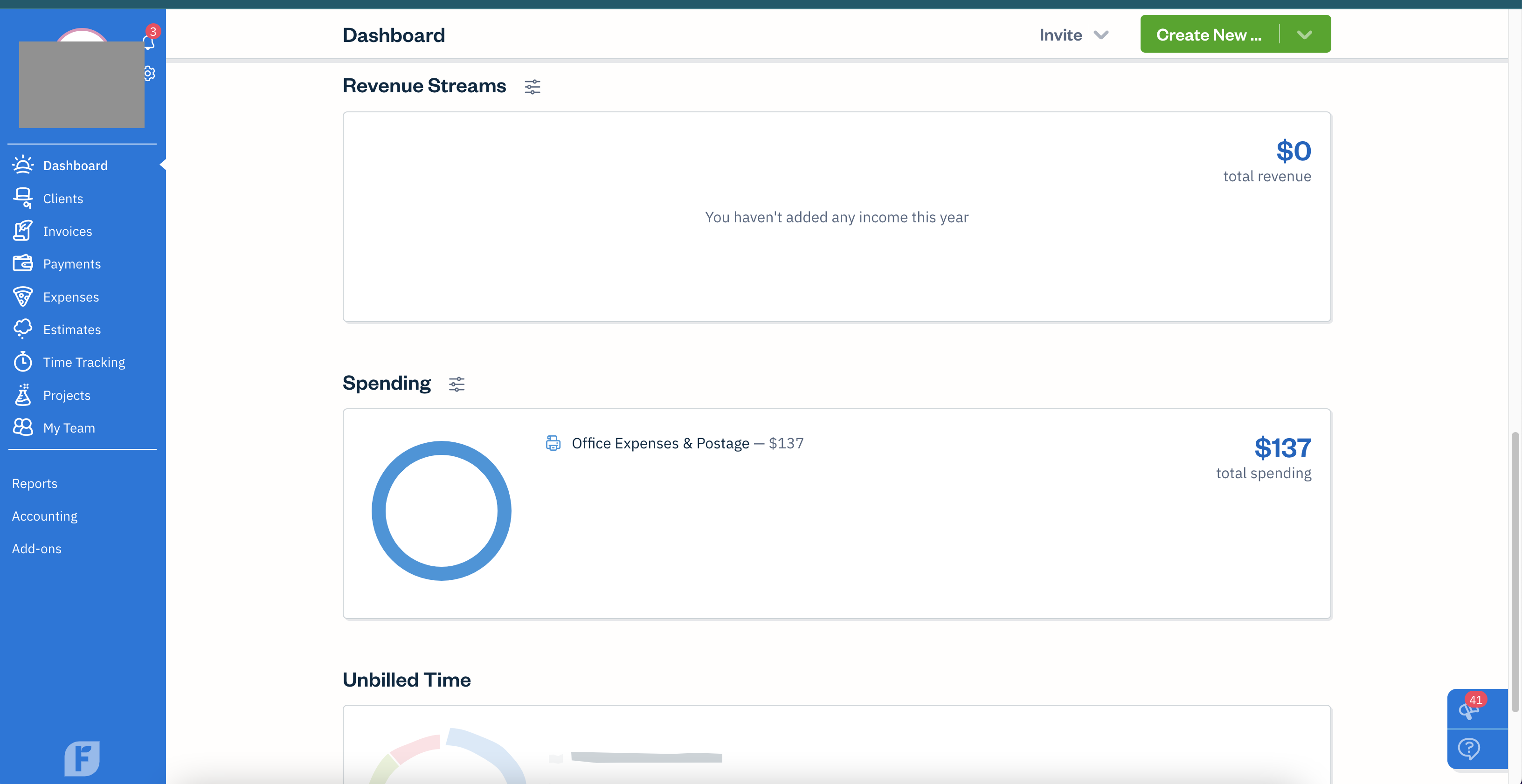

I know FreshBooks has a very similar interface to many apps, and I was hoping to recreate this functionality inside the new responsive engine on desktop.
functionality: I want a static sidebar, then a main body/content area that’s centred within the remaining space, excluding the sidebar. So the main content should have the same gap to the right screen border as it does to the left on the sidebar border.
Example:
Thanks!
Put main content in a group and make it column layout. Make that group take max available space. Make main content to be centre aligned.
