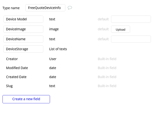

So Basically I have a database called Device Infos, It has data of phones. The fields in the data type are Device Name, Device Model, Device color (List of texts), Device Storage (List of Texts). I want the user to have a drop down where they can select their devices color and storage. I am trying to create a dropdown out of the storage but it shows as 256,123,455 instead of:

Sounds like your text list is being fed in as a single item text field. If the field on your device datatype is definitely a list of texts (not a single field containing a comma delimited list), then you should be able to just feed that directly into the dropdown.
Either the field isn’t set to be a list of texts, or you are modifying the structure somewhere before it hits the dropdown.
If you really want to keep the single text field, you could just use a split by(,) operator to create the list client side.

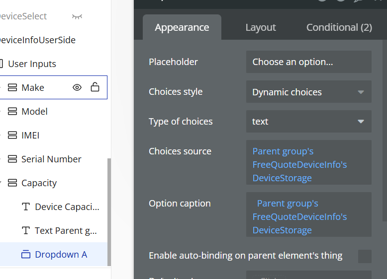

I do have the storage as a list of texts, Ill show you what im doing with the drop down.
Your Option Caption is Wrong.
Currently you’re using a List of Text as your Option Caption (the same List of text as your Choices Source - which measn each option will display as the full list of Text).
In your case the Option Caption should just be ‘Current Option’

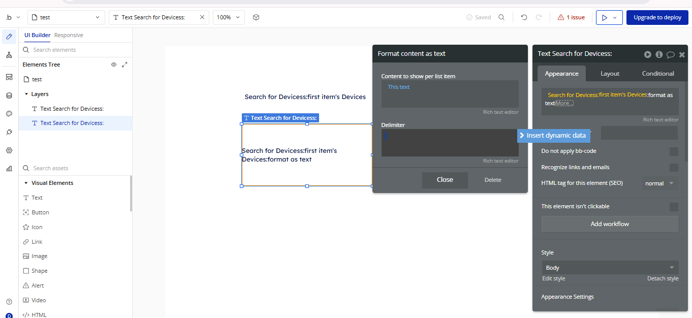

You can use format as text and in delimiter you need to add “Enter”
Below are some screenshots you can check:
let me know if it helps you. or you need something else
