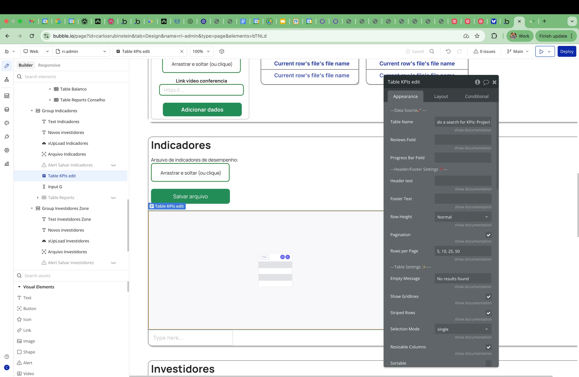

I’m new using Bubble. I’m having problem because all’s plugins or element that I used in bubble have (in apperance data source) the “insert dynamic data” to create a Do a search and his constrains.
But in “Edit Table like excel plugin”, this button (insert dynamic data) doesn’t exist.
So, I don’t know write the correct sentece.
I put this, but don’t work —> do a search for KPIs: Project (PR_startup_name = current project’s KPI_startup)

Hi @carlos.rubinstein,
I see you’re trying to use dynamic data to filter your “KPI” data in the Editable Data Table like Excel Pro plugin, but you’re facing an issue with the absence of the “Insert dynamic data” button.
Here’s what you need to do:
The “Insert dynamic data” button is part of Bubble’s expression editor. In the plugin’s Data Source field, click the field to open the editor, then select “Do a search for” > KPIs, and add a filter constraint like: KPI_startup = Current project’s Unique ID (adjust based on your data fields, e.g., using the project’s name or ID for matching).
The syntax you tried has errors - use Bubble’s filtered search instead of parentheses. This will ensure each startup sees and edits only their own KPIs.
Also, make sure you’re in Design mode (not preview mode) when trying to insert dynamic data into fields.

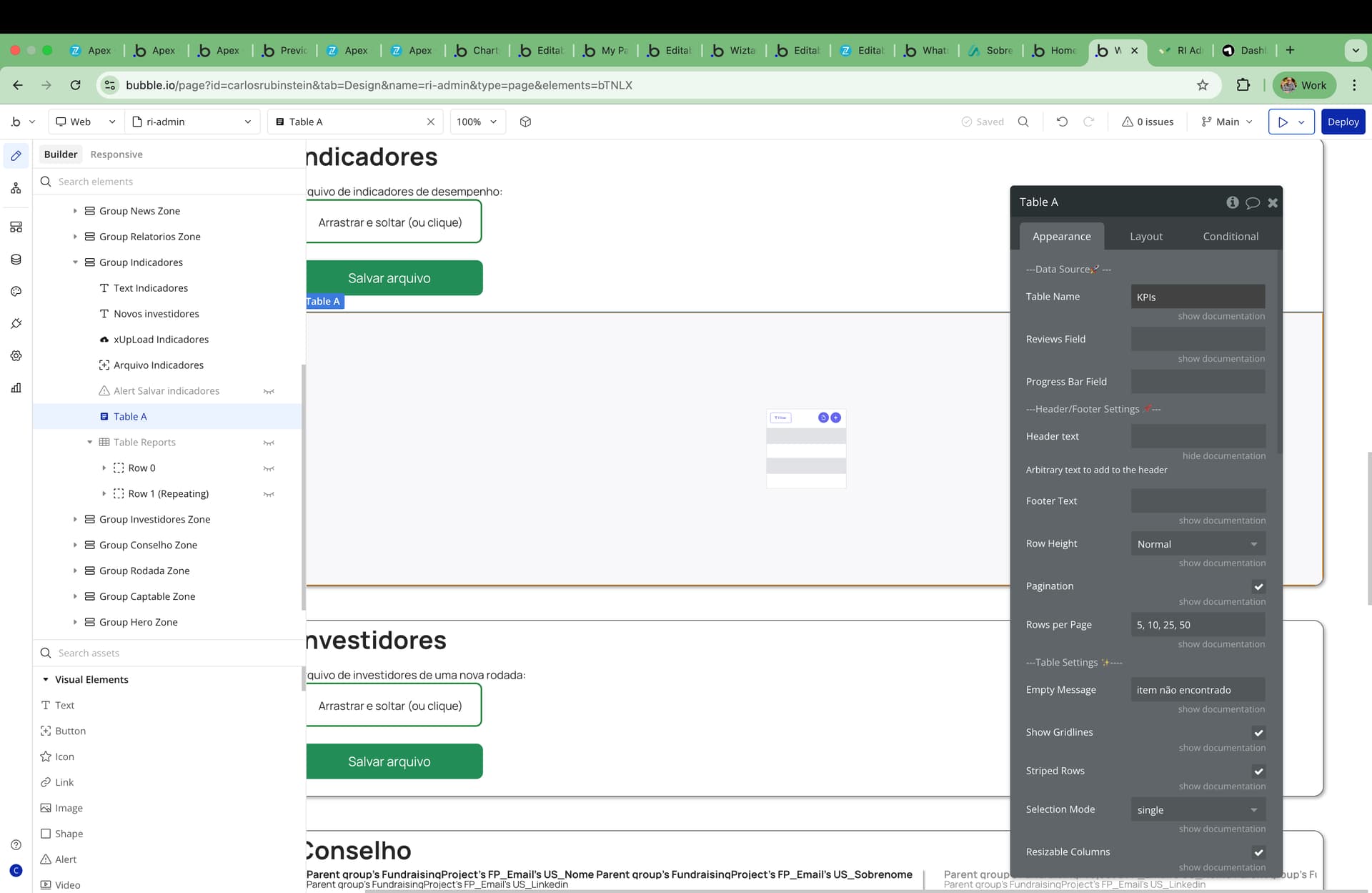

I’m very lost and confuse. Please, look in the image attached the available fields that the plugin show me. Are you using another version? I haven’t Column 1 data source.

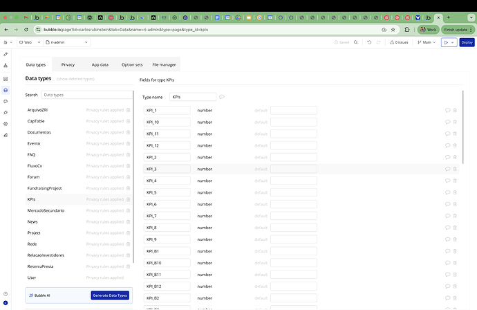

My requirement is Insert/Edit/Delete KPI’s from KPI Data Type.
See in attache the data type structure. (Project & KPI) KPI relations with Project (KPI_startup PR_startup_name)

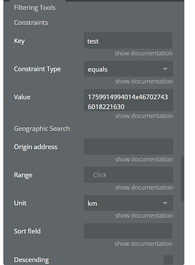

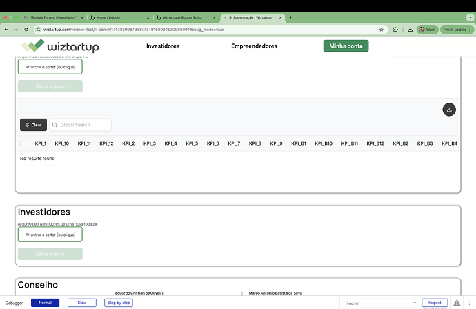

I ran some tests with the new version of the plugin. I think I’m not using the constraint correctly.
Both data types are linked by PR_startup_name → KPI_startup;
The configuration is in the images. But the table appears without data. If I don’t use a constraint, the data appears.
What am I doing wrong?

Hi @carlos.rubinstein :waving_hand:
Thanks a lot for your patience and for the screenshots.
From what we see, the table is empty because the filter is comparing different data types. In your screenshot, the Value is set to Current page’s Project’s PR_startup_name (a text), while your KPI field KPI_startup looks to be a Project (Thing) reference. When the filter does KPI_startup equals <text>, it returns no rows.
Please try this setup:
  1. Key: KPI_startup
  2. Constraint type: equals
  3. Value: Current page’s Project (the Project thing itself, not its name).
  • If the page isn’t typed as Project, pass the Project into a parent Group (Type: Project, Data source: the Project you want) and use Parent group’s Project as the Value.
  • If you truly store KPI_startup as text, then the Value must be the exact same text (but we strongly recommend keeping it as a Project reference).
Quick sanity check: temporarily set the Value to a known Project (e.g., “Do a search for Projects:first item”) and confirm rows appear. Also make sure no Privacy Rule is blocking read access for those KPIs.
If it still shows “No results found,” send us a short step-by-step recording (debug_mode=true) and a screenshot of the field types for KPI_startup and PR_startup_name. We’ll pinpoint it with you.
