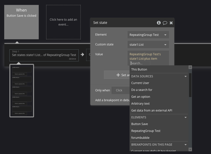

you have to save the whole rg and the list, create a custom states, set the states list of texts and list of files to the rgs stuff, then create a new thing, that should normally work
thank you moon, how to save the custom states value with create a new thing, for instance create a new thing specify a data type and fields add/=, then how to link custom state values to the field
there are multiple ways depending on what fits best for you, you will probably need two triggers to add something to the custom state and remove it, yo you would have a list and set the stae for add like this: Custome state :plus item/minus item to add whatever is in the repeating group or to what index of the repeating group you want to refer to, you can also set the entire repeating group as a custome state and only refer to current cells index so that would look something like Button clicked - custom states list item# current cells index

Yes you are right, when I wrote this i was really tired. My fault so I´am owning you an detailed instruction now:

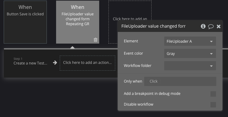

You either do An inputs value changed and then do this:
this will create immediatly a new thing, if you want to specifically says only the last edited row in the repeating group to be saved you would need something like this:
Example setup on the page i used:
if you want to save multiple things, so a list of the repeating groupe you would do something like this, but it depends on the use case:

You do: state1:list item#(the index/number of the current cell/list or your custome state) and then you can only create a thing for that item with the number 11 for example so if you have an list with about 20 items you would need to refer to the eleventh item if you want a thing to be created by an event caused outside the repeatig group
