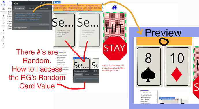

How do I get the sum of Random Numbers in a Repeating Group
How do I get the sum of Random Numbers in a Repeating Group?
Any assistance would be greatly appreciated! I’ve been ‘spinning my wheels’ for days and need help out of this ‘rabbit hole’. Please and thank you!!!

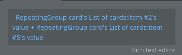

In order to get the value of the “card” at a specific index you need to do Repeating Group (repeating group’s name)'s list of whatever your data type is :item# ____. This is what your data source would look like:
Screenshot 2023-08-29 at 2.40.13 PM
Let me know if this fixes your problem,
Aanya

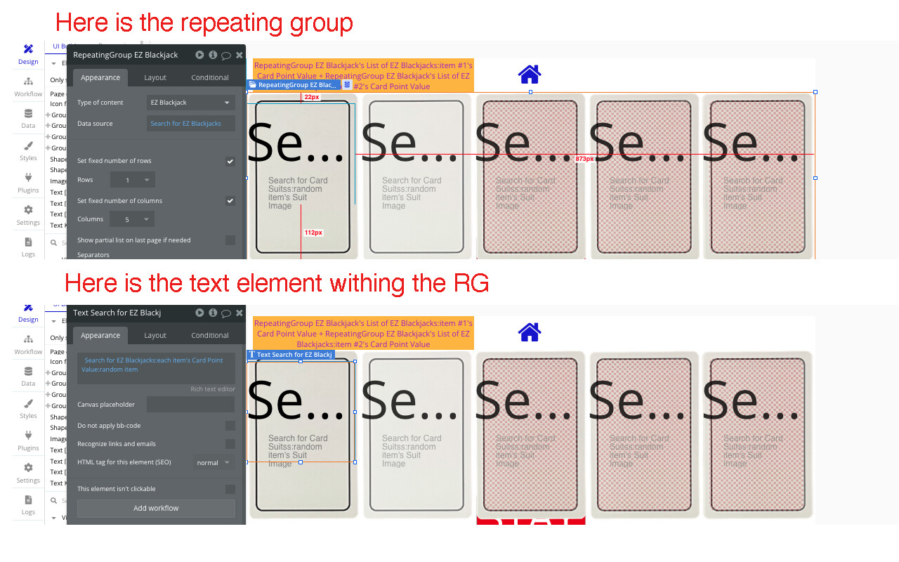

Hello! Thank you for your response. The Card Value is being generated randomly by the Text Value within the RG and I am trying to calculate those Random Numbers.
Am I generating the Random Value in the correct place?
Thank you Aanya! It’s adding up correctly now. I changed the Point Value to be current’s cell’s point value and changed the repeating group to do a search and sort by random string. Again thank you for your help!
