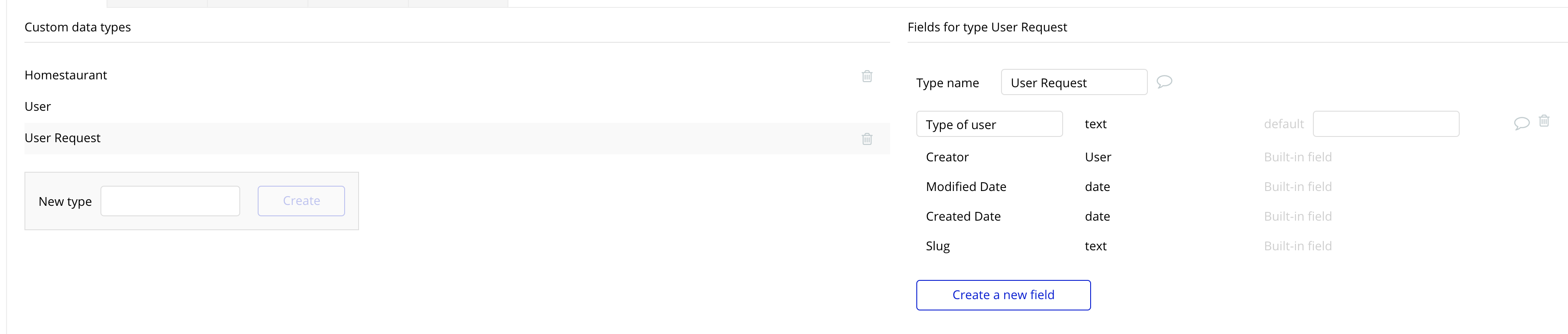

I have 3 types of users, X, Y and Z. I am having them select who they are during the sign up flow.
I created a data type just to differentiate those types (as per the screenshot)
I would also make another data type for each of X, Y and Z. And fill each data type with the data from the multistep sign up process. Example of X data type fields (screenshot)
I’m unsure if I’m doing things right so far? Any guidance will be super helpful!
Ah, okay… I definitely would have gone a different route with the 3 types of users. I would use an option set to define the different user types, and I would have a type
field in the User
data type to store the type for a user when they sign up. Then, it’s kind of hard for me to say exactly where I would go from there because I know nothing about your app, but I would likely have one or more additional data types to store the details for the different user types (as opposed to storing everything in the User
data type), and the specific steps/inputs that are presented to the user as part of the multi-step sign-up process would be driven by a user’s type.
The above being said, though, it all comes back to the workflows of the multi-step process. In the first step, you would create a new thing in the custom data type, and in the subsequent steps, you would make changes to the thing you created in the first step. That’s the way to get everything for a particular user associated with one row in the custom data type.
You could also consider keeping the results of the multi-step process in custom states and then creating a thing in the custom data type at the end of the process… just more food for thought.
