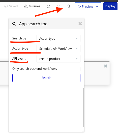

You can use the App Search Tool and looks for the workflows triggering the backend workflow.
If you have an external application calling your backend workflow, it will be harder to track.
