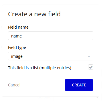

If I understood well, you need to create a fild with type image and check the "This field is a list (multiple entries) box, as seen bellow:
Sadly you can’t “edit” a field type to make it a list. So you’ll have to create a new field type and delete the old one, in case it won’t be used anymore. An important tip is: before deleting the old field, use the bubble app search tool (magnified glass icon on top right) to see everywhere you’re using the old field and changing it to the new one before deleting the old field. This way you won’t end up with any unseen bugs. Here is an example:
