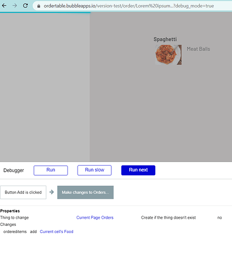

Sure. Here’s the page settings:

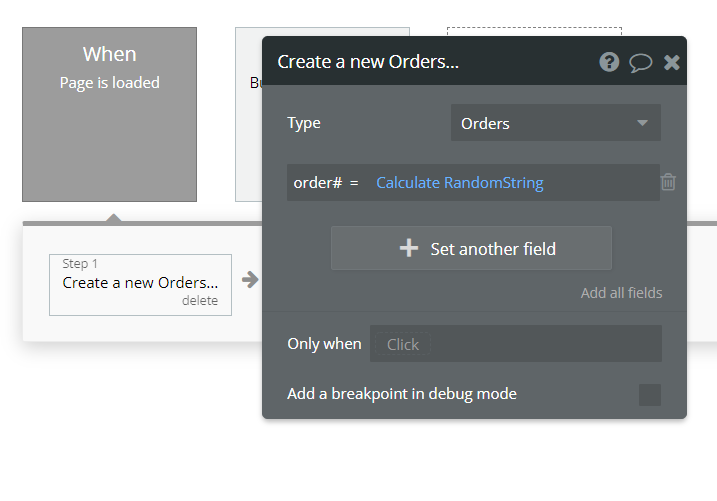

here’s how the order is being created:

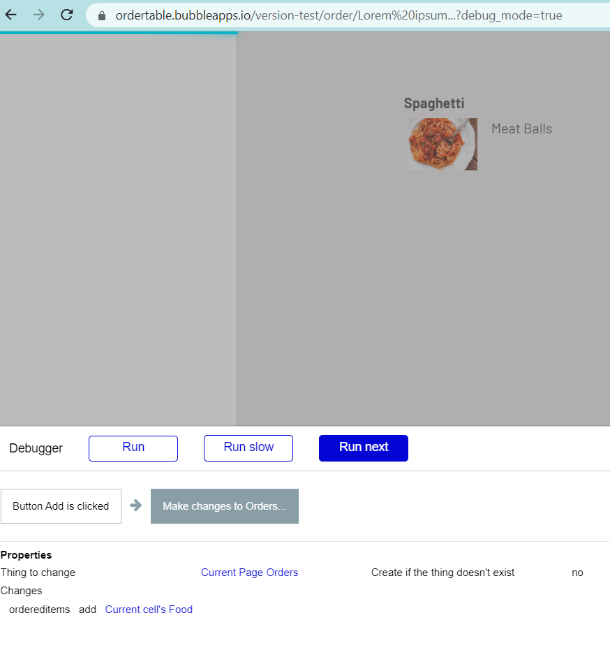

here’s how the workflow is set to add the food the current order:

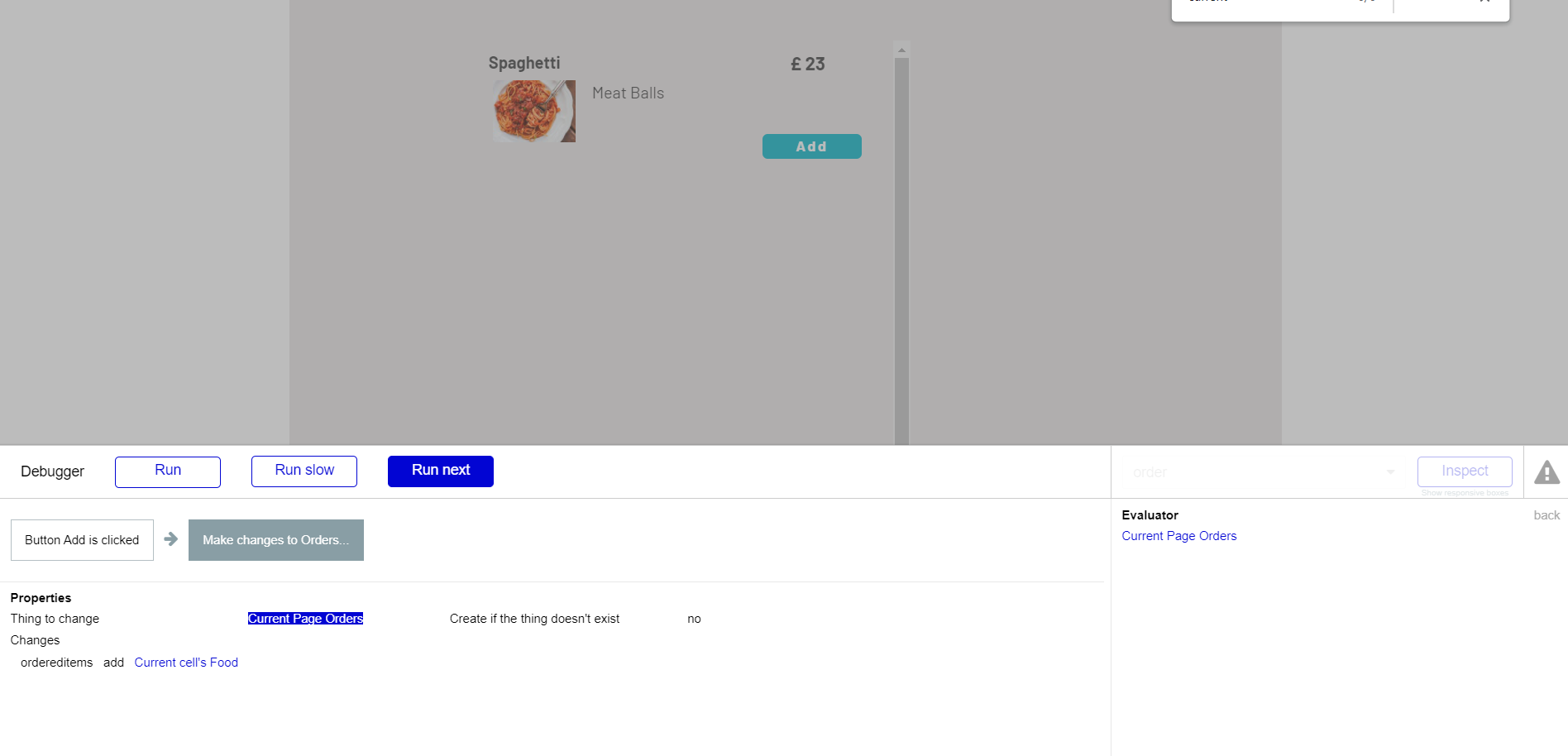

here’s the debugger showing the order number being created:

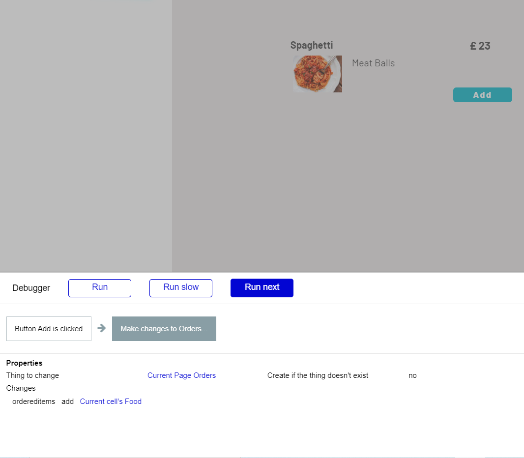

Here’s the debugger adding the item which never gets added to DB for some reason:

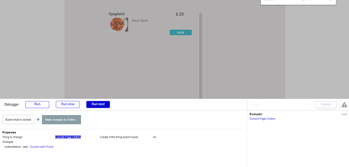

You are not sharing the debugger with Current Page Order
selected so we can see the value of the order.
Anyways, I think the Current Page Order is empty.
Just after you create the order, navigate to the order page (the same page you are in) and in the Data to send, add the order (Result of step 1…)

Is this what you were asking for?:
