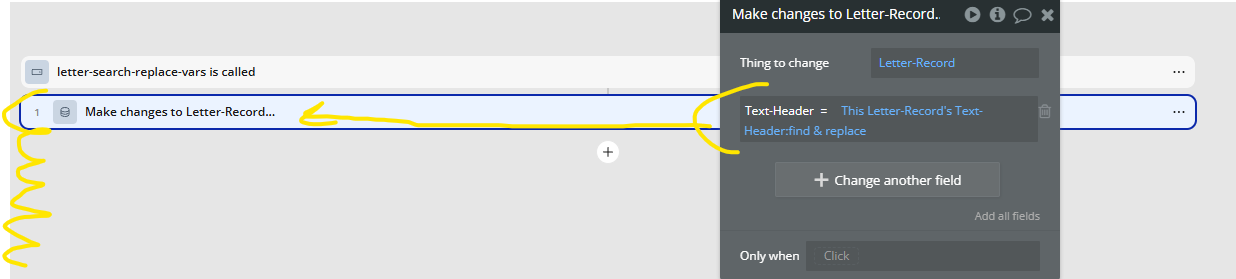

Would I do the 50 make changes to X then in the side I set the find an replace for an attribute?
Or what better way to keep it maintainable?
I pictured just a long chain of 50 :find&replace…
But you want it easier to read you could make a custom event that takes in the whole Letter-Record’s Text and have another parameter for what the Find and another parameter for what to Replace it with. then within the custom event return the whole text with the replaced value. then chain together the custom events instead and you can rename the custom event trigger actions
