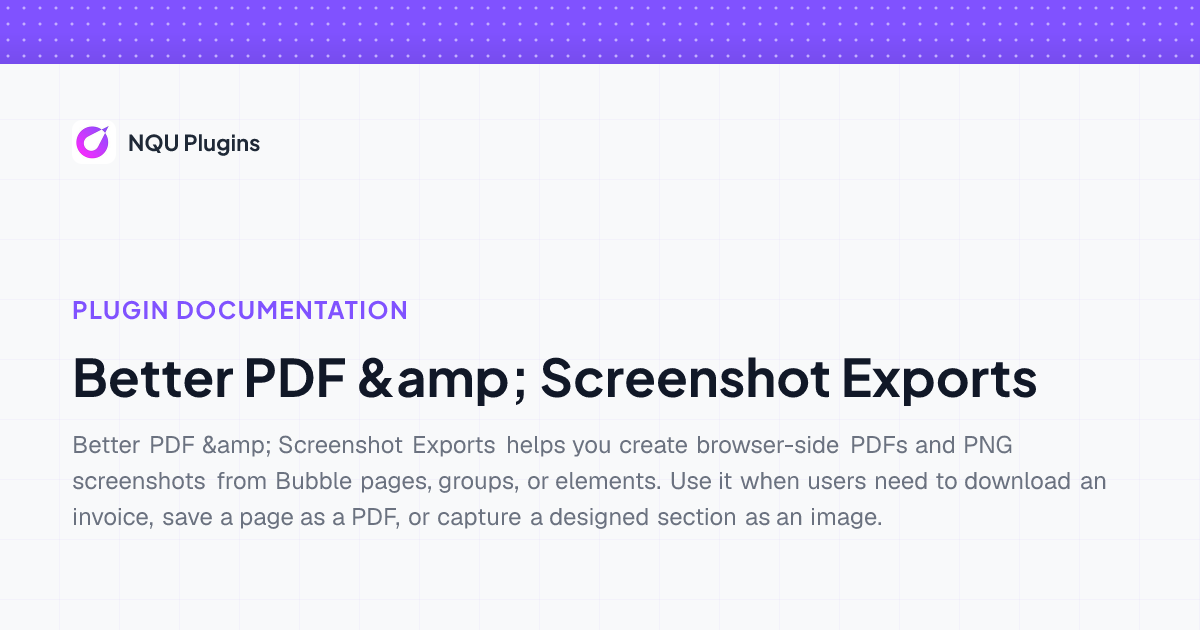

It’s a free download, took me quite a bit to figure out how to use.
Yeah, I’ll keep it real. I haven’t been able to figure out how I would do it. It’s really confusing. If you didn’t have to set a custom state for the link and it just came from the workflow, it would look a lot better.

I’m confident the plugin is doing what it’s supposed to do. It generates the link to the saved image in the file manager, the link is displayed on the page and I can verify it’s in the file manager. It also generates a download, which of course appears in the browser. These functions take only a second or two.
The problem now is to send the file in an email from the file manager. Apparently, bubble Send email will not “attach” the file in file manager even though the link (or output file name) is used. Even worse, the Send email won’t even recognize the link as a text when the dynamic link is used in the body of the email. Bubble chat bot confirms this.
So, there appears no way to use Send email to attach the file or send the link. Disastrous! I also tried the Postmark Send email, did not work either. Actually, very strangely, the attach file function worked for 2 or 3 times, then stopped working.
The way other png generators work is they attach the generated image by using Result of Step X. Unfortunately, the Better PDF Screenshot does not have that option. The other generators have other problems, so they appear to be unreliable as they time out during their generating process.
