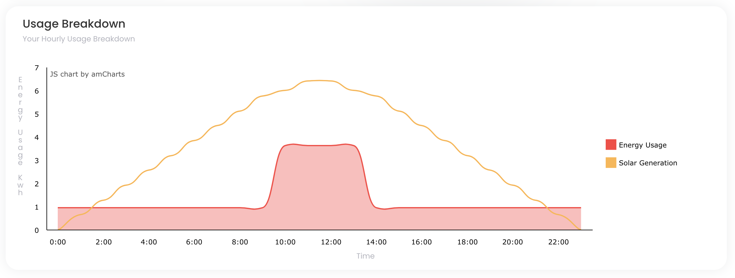

Essentially, my app is a solar energy load calculator and what I want to achieve is something like this:
This is a breakdown of power usage in 3 hour chunks and it is a graph I made in minutes using basic javascript on my non-bubble version of this web app. However In bubble, it seems extremely difficult to perform basic operations on arrays/lists of numbers…
In my program (bubble) I have 4 different numbers representing power used at morning, mid day, afternoon and night… I’d love to be able to insert the information from these lists into one array (24 numbers long) by portioning the power usage into each hour chunk (averaged) so I can graph power usage over a 24 hour timeframe.

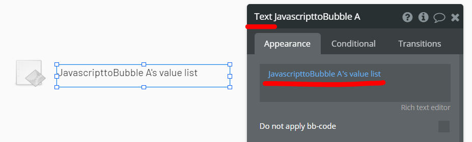

  1. Place the element “JavascripttoBubble” in you page to be able to catch the generated array
  1. That is it. You can now access the array using the “JavascripttoBubble A” element, as below:
Im my case I use it in a Text Element, but you can use it anywhere. The result was this:
Hope it helps :+1:
