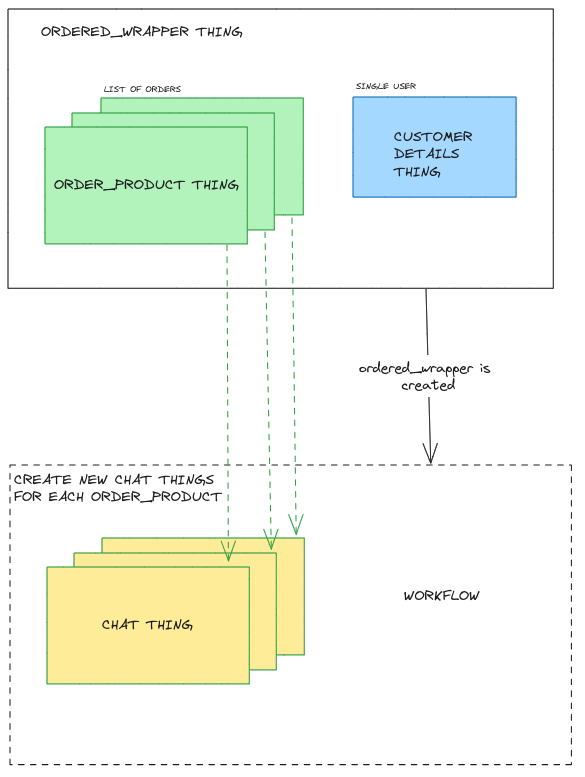

Guys I have a table called Ordered_wrapper in which has a field called orders that receives a list of order_product.
Basically, once the Ordered_wrapper is created with the list of Order_products I need to create a thing Chat for each order_products of this ordered_wrapper.

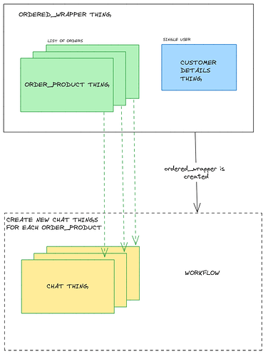

Here is an example of each one Chat thing is created for each order_product thing from ordered_wrapper thing:
Telling that Chat has a relationship with order_product:
Chat table:
  • order_product → Order_product
  • messages → List of messages…
Here is where I am having a hard time to bring the solution of creating a new chat for each order_product:

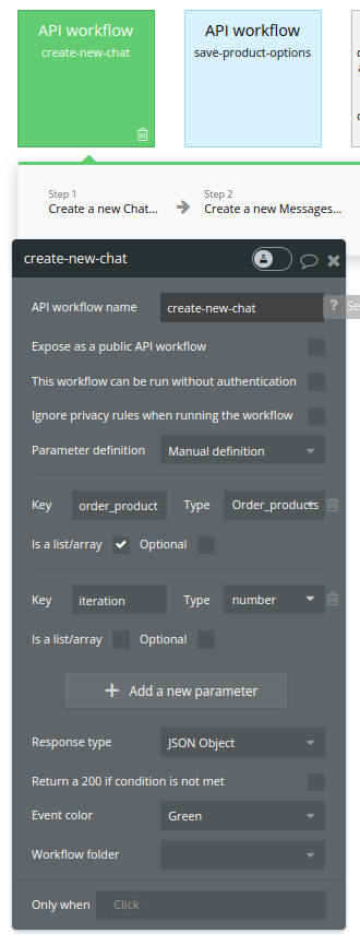

FIRST STEP: I created an API workflow to create new-chats, where I passed the “order_products” param as list of Order_product thing and the “iteration” param as number.

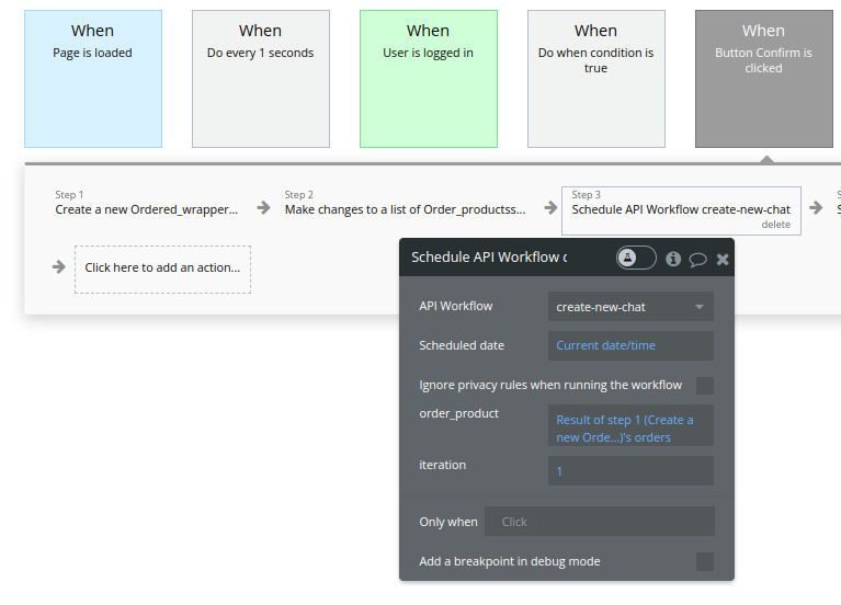

SECOND STEP: I scheduled this API workflow I have created before, when I click the confirm button, where the Ordered_wrapper* thing with the list of Order_product things will be created, passing the list of the Order_product list to the backend through the API backend workflow.
See the order_product param receiving a list of order_products thing as “ordedrs” (different name):

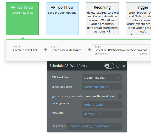

THIRD STEP: I scheduled the API workflow within itself (that is why the name recursive) to iterate and create the loop passing the params again. Remembering that within the condition I make an EXIT expression to stop the iteration when the iteration param be smaller than the number of order_products.
